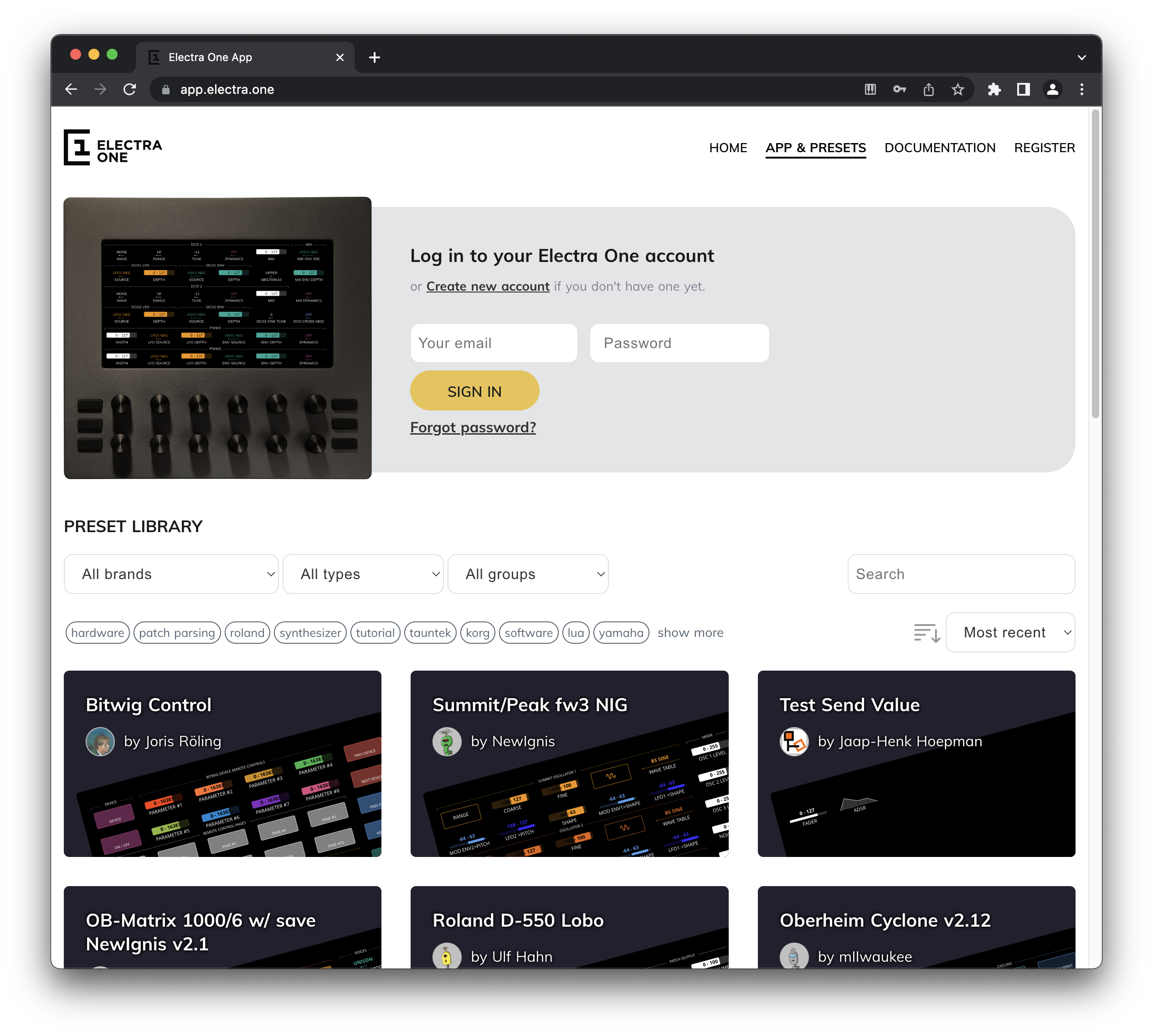

Signing in
Signing in to your Electra One application account is required for accessing the Preset library and the Editor.
Electra App login page
Once you sign in, you get access to two distinct libraries of presets. One is owned by you while the other is the library of all presets shared by other Electra One users.

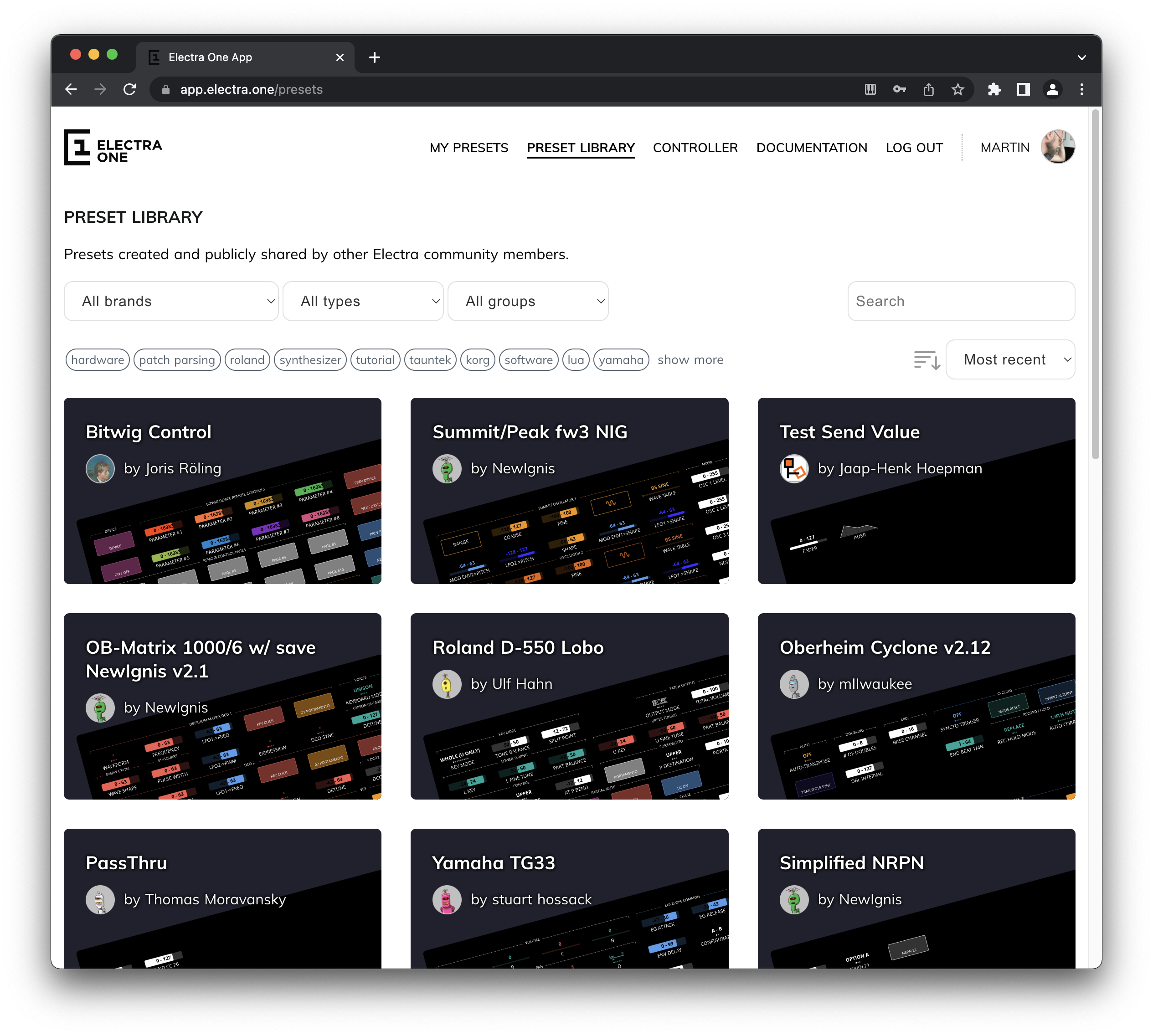

Preset library
The Preset library is a collection of all presets maintained and shared by other Electra One Account users. A click on the preset tile takes you to the Preset detail page. The tile also gives you an option to send the preset to your Electra One controller directly from the list.
Preset library

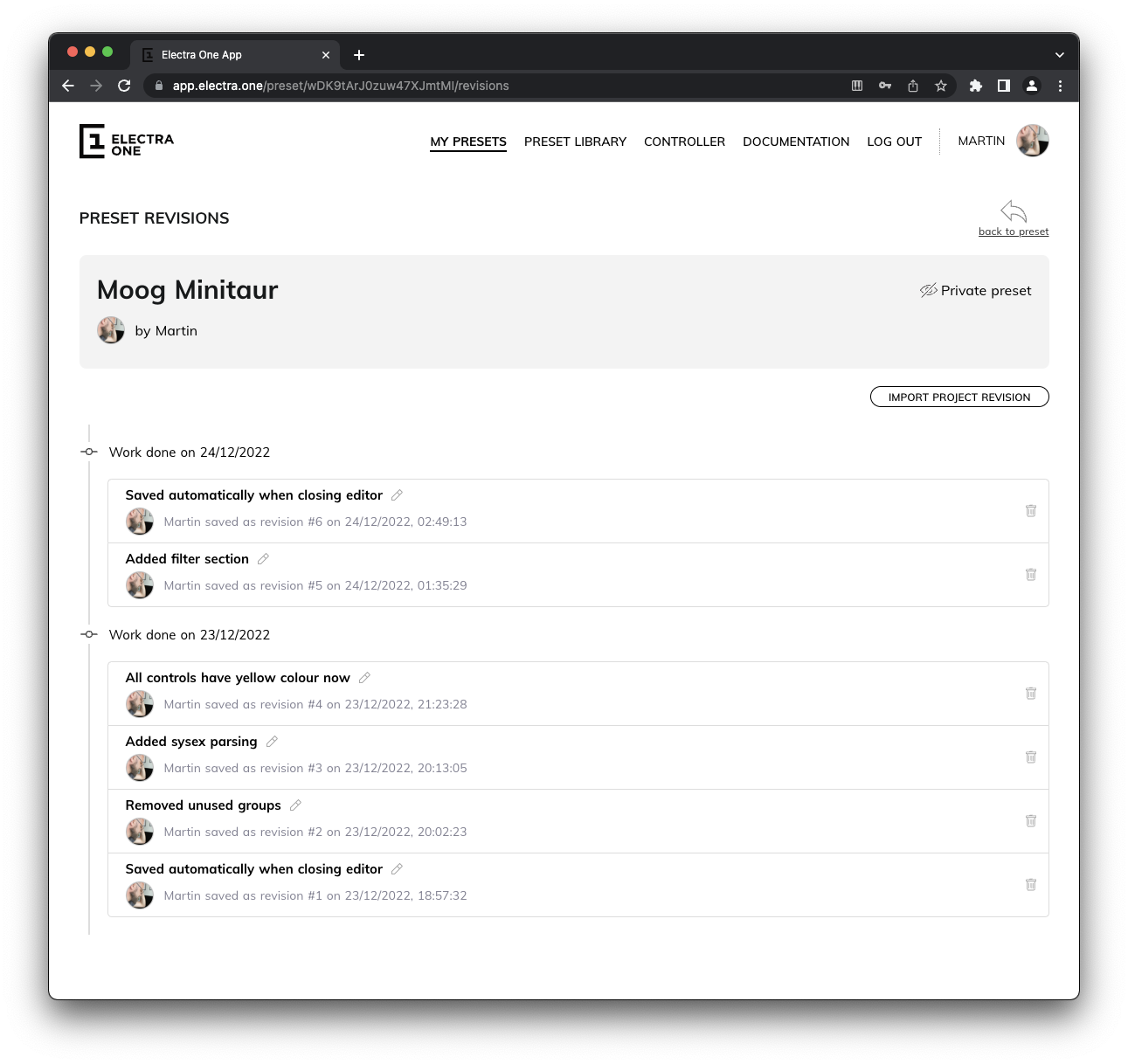

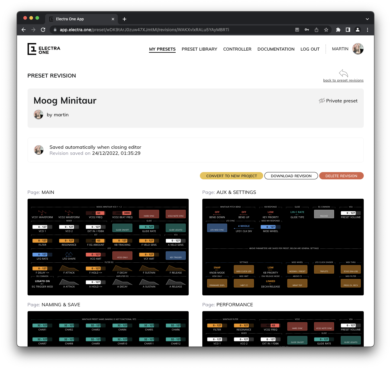

Preset revisions
Preset revisions can be accessed by clicking on the previous revisions link in the Last updated section. The preset revisions is a powerful system of saved versions of your presets. It allows you to mark important steps and milestones in process of preset development. If needed, older revisions can be re-called later and converted to new presets.
Preset revisions
Saved revisions are created whenever you save a preset. When saving a preset, you can add a short annotation the describes work done in that revision. The editor also creates revisions automatically whenever there are unsaved changes and you send the preset to the Electra One controller or you quit the Preset editor. For more information about saving revisions, please refer to Revisions in the Preset editor documentation.
Preset revision detail
Revisions can be also used to transfer changes between private and public presets. Imagine a situation when you need to make changes to a preset that is already shared with other users. In such situation you might want to publish the changes only after you finished and tested your work. To do that safely, you can do all your work in a private copy of the preset and import the final revision to the public preset.

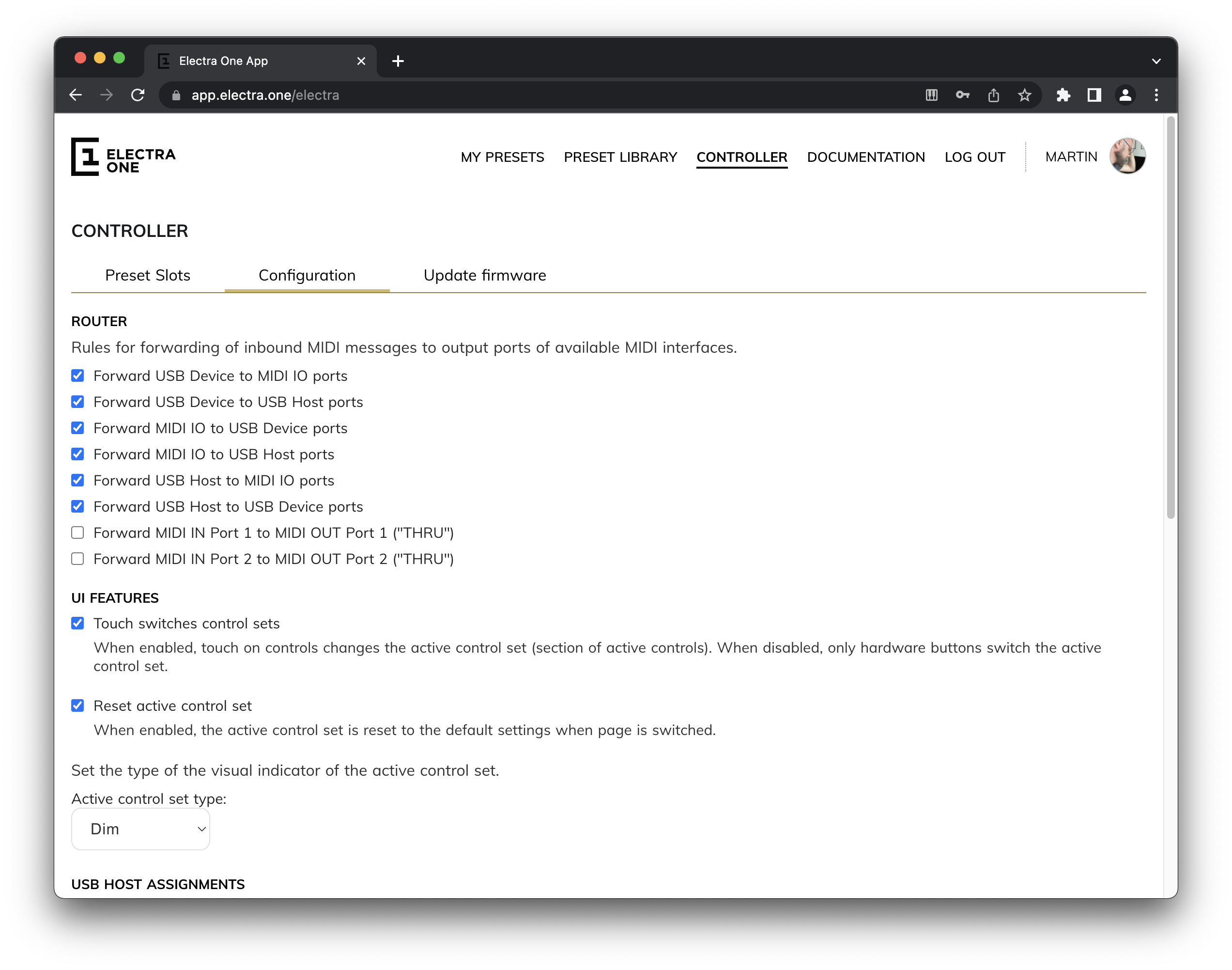

Configuration
The configuration affects the way the Electra One behaves. There are five areas that can be configured:
  1. MIDI Message forwarding.
  2. Behaviour of the user interface.
  3. USB Host device assignments.
  4. External MIDI control.
  5. Setup of preset banks.
Controller configuration

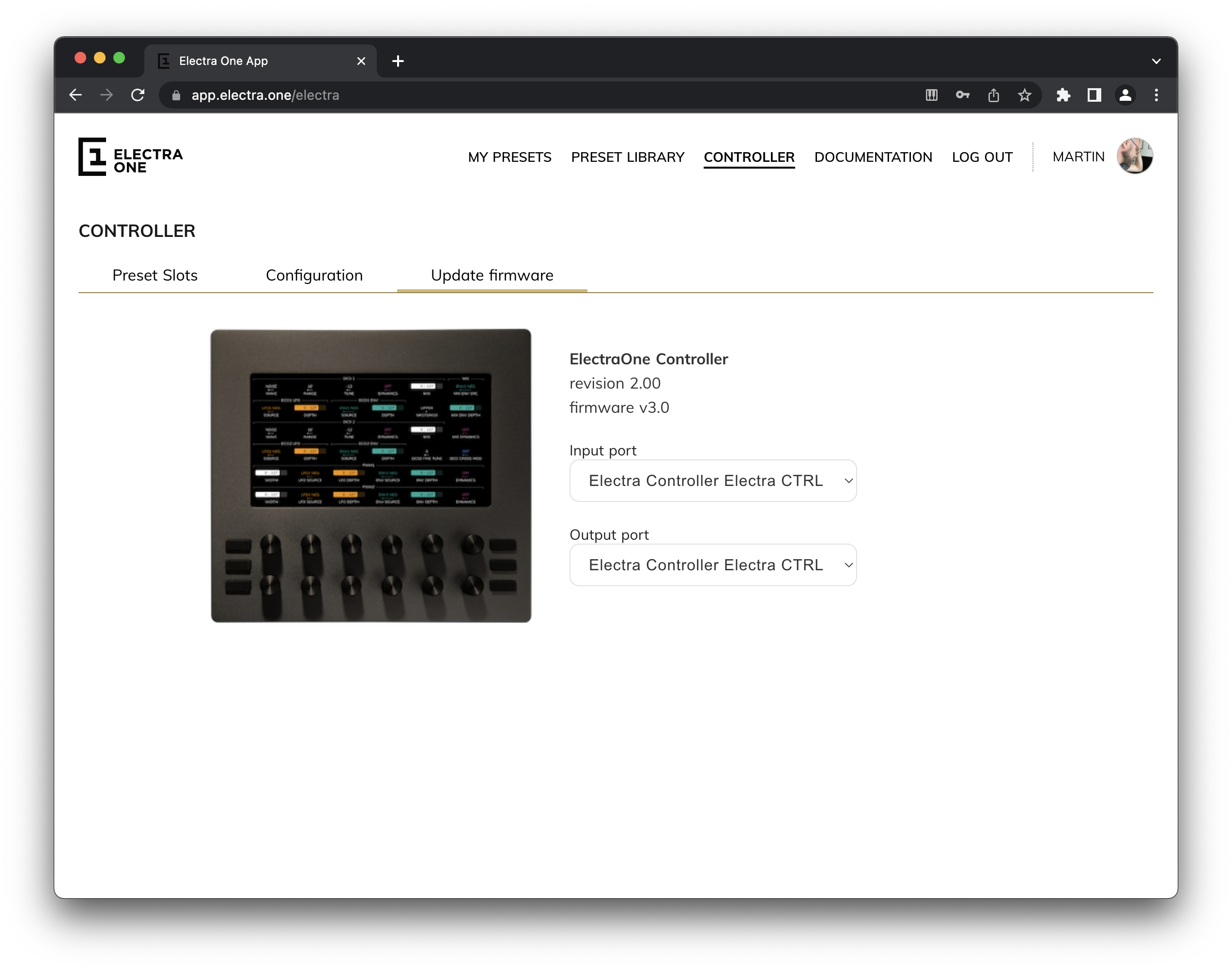

Firmware update
The controller firmware can be updated directly from the Electra One Account. Detailed information about the firmware updates is described in dedicated document.
