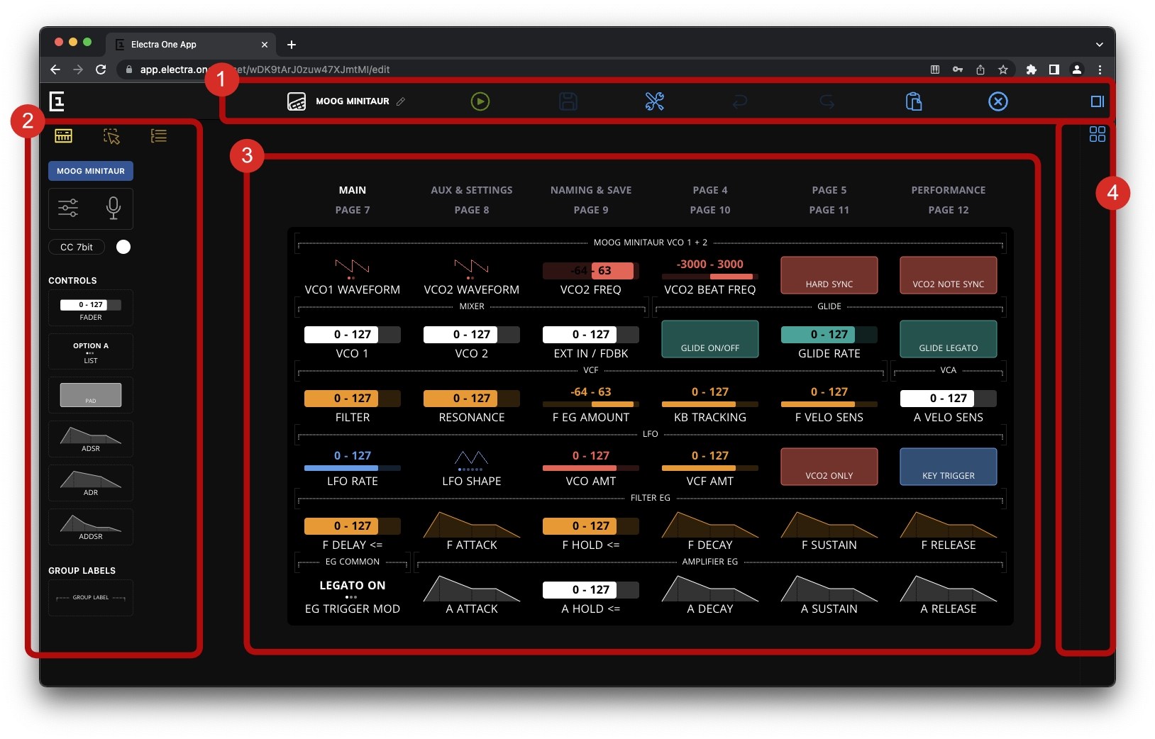

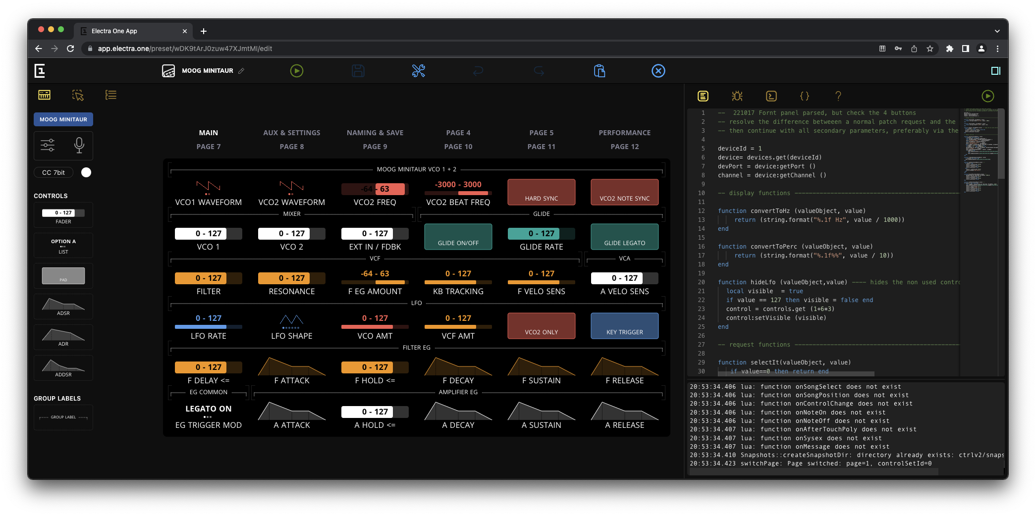

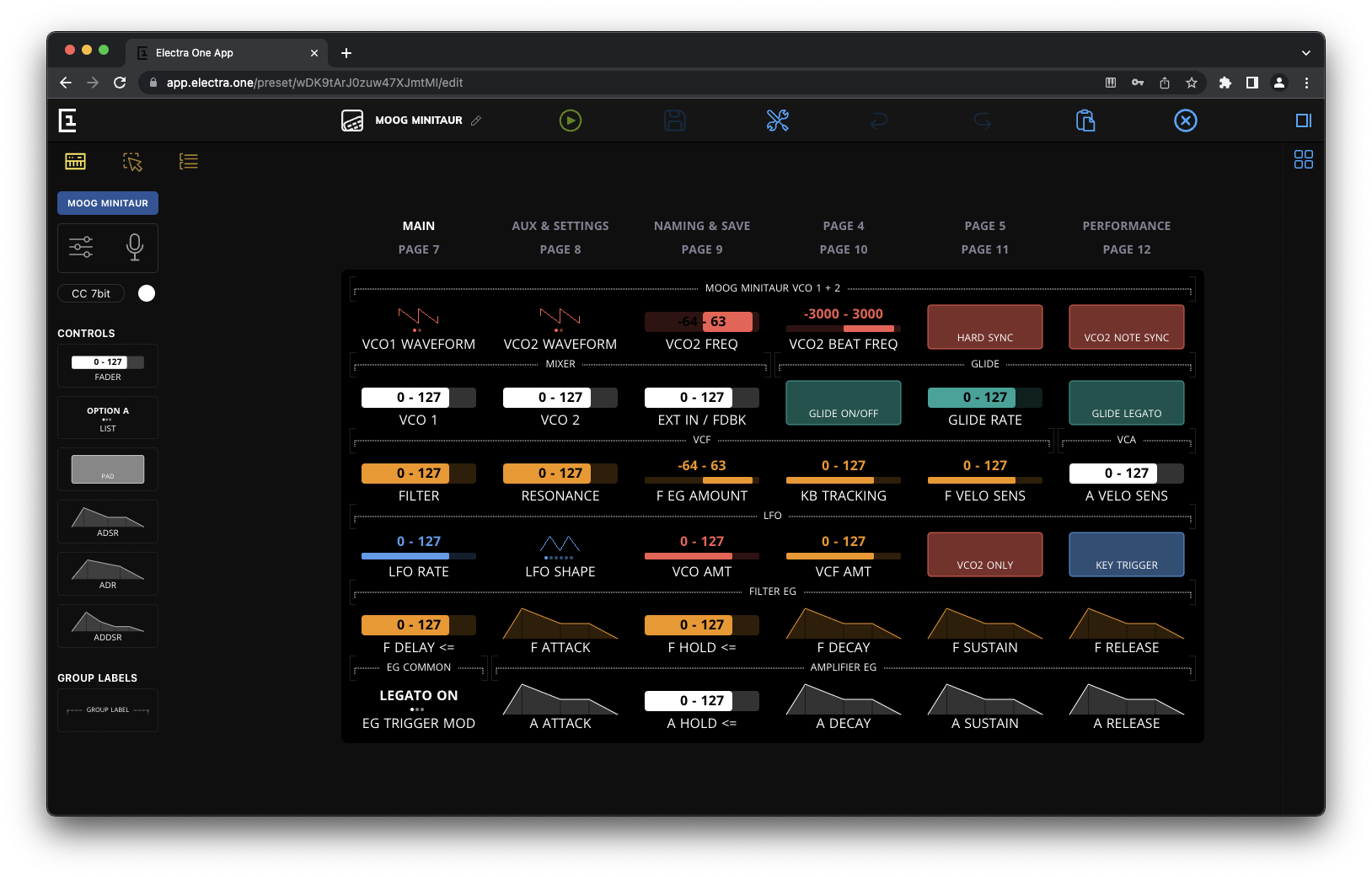

Editor overview
The Preset editor window is divided into four sections:
Editor overview
  1. Top menu
  2. Sidebar
  3. Grid
  4. Tools pane

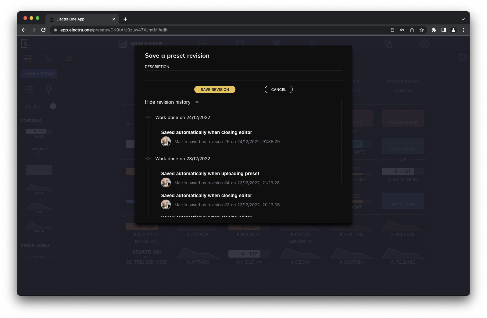

Save a revision
Editor overview
Saves a preset and creates a new saved revision. For more details, refer to Preset revisions section of this document.
Open Toolbox
Editor overview
Opens a Toolbox. A collection of handy tools to edit and debug Lua script and MIDI Console to send and receive MIDI messages.

Open the Tools pane
Editor overview
Opens a Tools pane. A sidebar on the right side of the editor window. The Tools pane contains the Toolbox, a set of tools described above.
Editor overview
The advantage of the Tools pane is that the Toolbox can be opened while editing the preset. A wider screen is required to accommodate the Tools pane next to the Grid. The width of the Tools pane can be adjusted with the resize handle - the thin grey vertical bar between the Grid and the Tools pane.
The Sidebar
The Sidebar is on the left side of the editor window. It consists of three panels that allow user to edit controls, devices, pages, and categories. The Sidebar menu is used to switch between the three Sidebar panels.
Sidebar menu
The Repository panel
Sidebar menu
The Repository is the default panel. It provides user with information about currently selected device, allows user to edit the device, start/stop the MIDI learn, and offers a selection of Controls to build the preset. The Controls can be dragged from the panel on the the Grid with a mouse.
Repository panel
The device section
The device section is there to switch the currently selected device, edit the device details, and enable/disable the MIDI learn function. The detailed description of the device section is described further below in this document.
Repository panel
The defaults
The defaults allow user to set the default MIDI message type and color for Controls that will be dragged on to the Grid. There is a handy shortcut for changing the default color - pressing keys 1 to 6, while there are no controls selected, will set the default color from the Electra One color palette.
Repository panel
The Repository of controls
The repository of controls is a selection of controls available for currently selected device. User can drag and drop the controls on to the Grid to build the preset. The message type and the color of the newly created control reflects settings of the defaults, see details above.
Repository panel

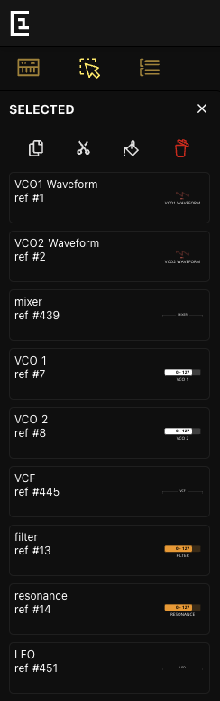

The Selected panel
Sidebar menu
The Selected panel is activated whenever user select one or more objects. It can be controls, groups, or pages. The Selected panel allows the user to edit properties of the selected object. If multiple objects are selected, a list of objects is shown and the user can perform actions on all selected objects. Currently, users can cut and copy selected objects to the clipboard, change their color, and delete them.
Selected panel
The Selected panel with one selected object is described in detail further bellow.

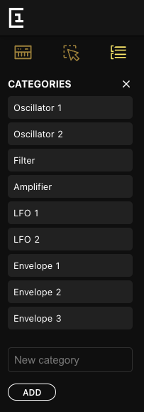

The Categories panel
Sidebar menu
The Categories are meant to organize your controls to logical groups. When control has a category assigned, the category name is shown along with the name of the control, making it easier to get oriented.
Categories panel
Grid
The grid mirrors Electra One controller display. User places the controls from the repository panel to the grid by dragging them with a mouse. Drag and drop is also used to move Controls around the Grid.
Drag and drop
Selecting controls
Individual controls are selected with a single mouse click or by navigating the Grid with keyboard arrow keys. Selecting multiple controls is done by clicking on the left-top control of the selection and then the SHIFT-click on the right-bottom corner of the selection. Selected controls and groups are highlighted with a dark-blue background.
Multi select
Keyboard shortcuts
The grid can be also navigated with keyboard arrows and several handy keyboard shortcuts are supported:

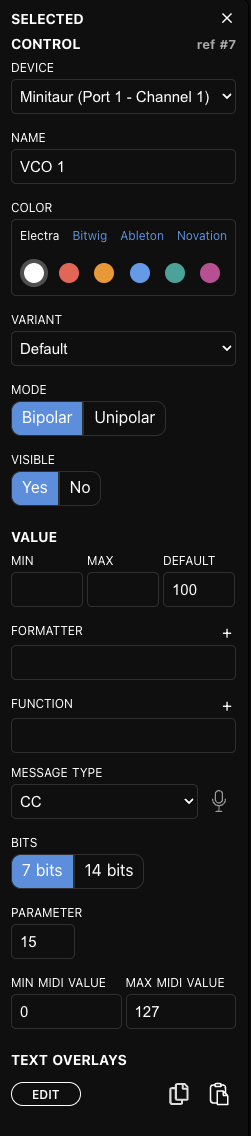

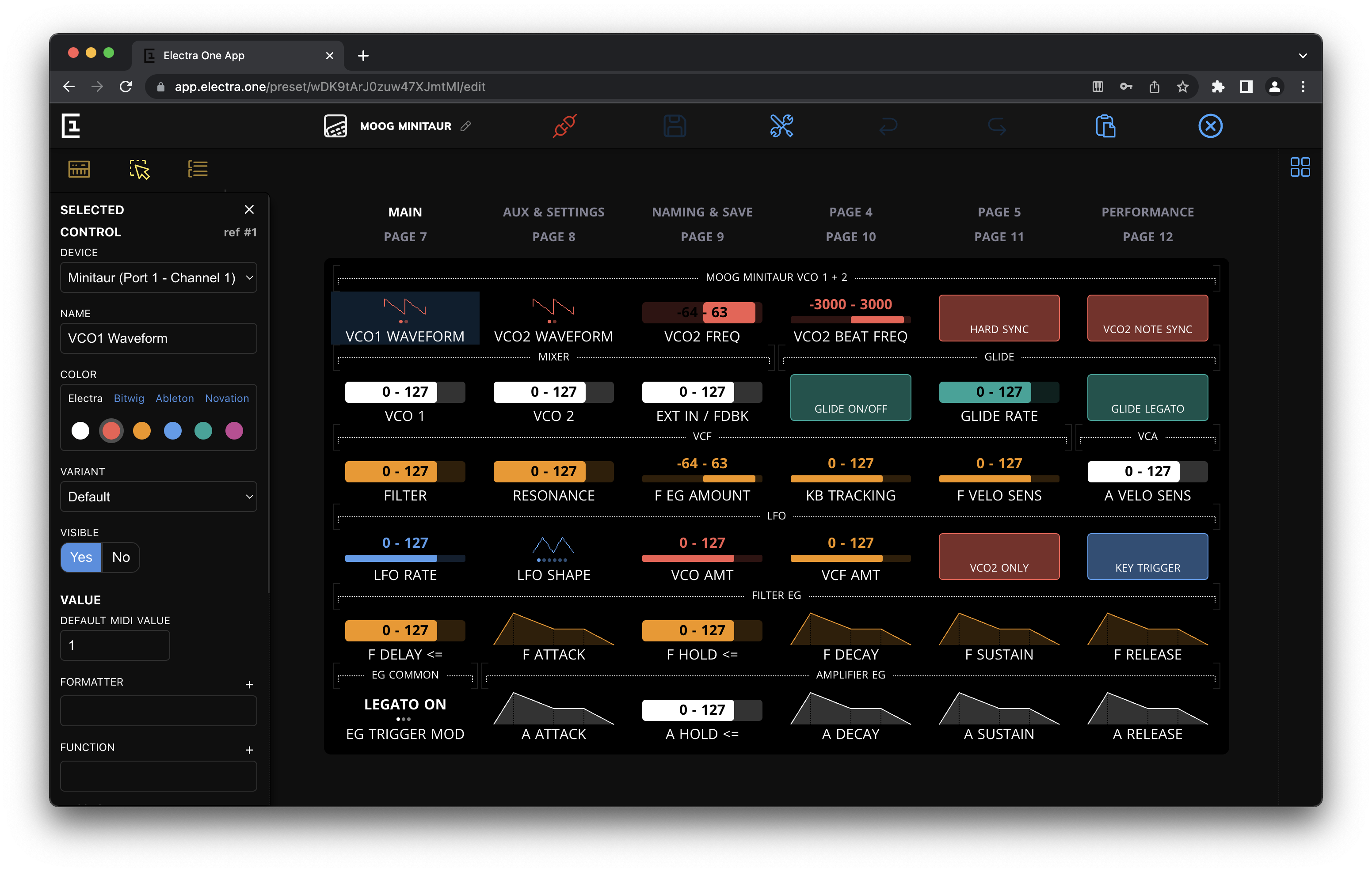

Control attributes
Each Control has several attributes to configure. Some of the attributes are common for all types of Controls, while others are available only for certain types of Controls. The Control attributes are shown on the Selected panel on the left side of the editor window when single Control is selected on the Grid.
Control detail in sidebar
The Control attributes are divided into four sections, with each section covering different part of Control's functionality:
  1. Common attributes, such as name and color.
  2. Value attributes that configure how the value will be displayed.
  3. Message attributes, that say what MIDI message is associated with the Control value.
  4. Text overlays and list values.
Multi-value controls, such as envelopes, have several Value sections present, ie. for an ADSR envelope, there will be Attack, Decay, Sustain, and Release value sections.
Examples of Control attributes
The fader
Fader attributes
The list
List attributes
The pad
Pad attributes
The envelope
ADSR attributes

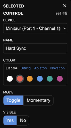

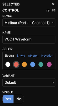

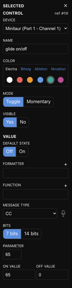

General Attributes
As the name suggests, the general group of attributes covers attributes common to all types of Controls.

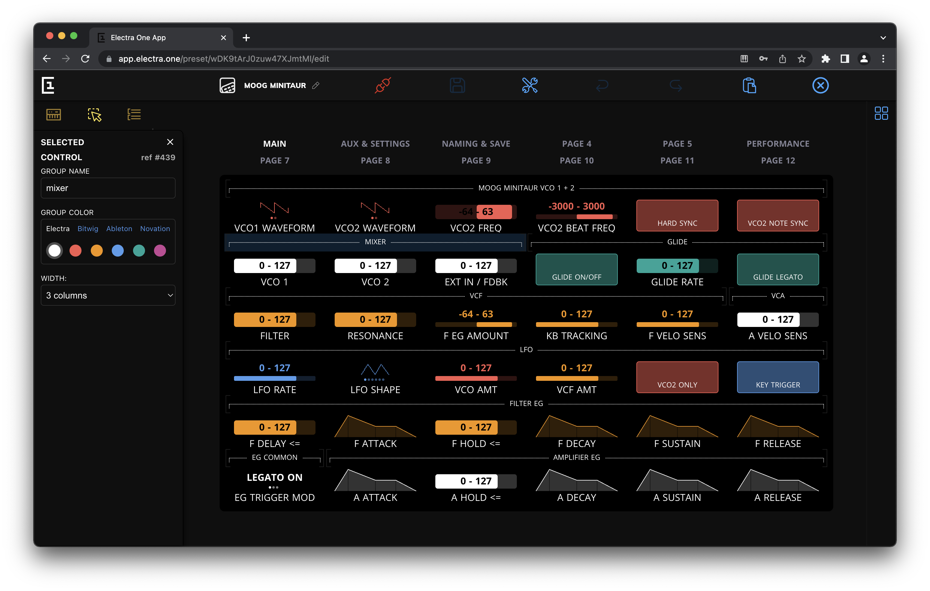

The general attributes allow user to assign the Control to a device, set the name, color, variant, and mode. When the preset includes a Lua script, the visibility toggle is shown too.
Fader attributes Fader attributes
Device
An identification of the synthesizer, sampler, VST plugin, or any other MIDI device where the MIDI messages generated by the Control will be sent. An example of a device is “Yamaha DX7, Rack 1”. The device represents a particular synthesizer connected to a MIDI port and channel.
Name
The name of the Control that will be shown on the display. The name is shown below the value. For example, a “Filter cutoff”
Color
Color of the Control. It is up to the user how the colors are used. They are meant to improve the readability of the presets and to help to organize controls to logical clusters of parameters. For example, users might want to have all Controls of one device sharing the same color or to have one color for all parameters related to the VCF.
Variant
Variant of the Control. The variant affects how the Control looks like. For example, you can choose between regular and thin faders. Some controls have more variants while others may have only the default variant.
Mode
Mode of the Control operation. The mode affects how the Control behaves. For faders you can choose between unipolar and bipolar functionality. For pads, you can choose between momentary pads and toggles.
  • Momentary pads always return to the Off position after they are released
  • Toggle pads act as switches between the Off and On values

Message attributes
The message attributes are used to describe the MIDI message associated with the Control value. It means what MIDI message will be send out when user changes the value and how the MIDI message value will be calculated.
Type
The parameter type defines the type of MIDI message assigned to the Control. Whenever the value of Control is changed by turning the knob or with touch, a given MIDI message will be sent to the connected synthesizer. On the receiving side, whenever there is a MIDI message coming from a connected synthesizer and it matches a parameter settings of the Control, the value of the Control will be updated accordingly.
Electra supports the following MIDI message types:
CC
7-bit or 14-bit Control Change MIDI message. The value of 7-bit Control change is restricted to a range of 127 values. There is an option to switch CC to 14-bit Control Change mode. 14-bit Control change follows the MIDI standard which says that the first 32 7-bit control change messages (CC #0 .. CC #31) can be used as 14-bit messages. The parameter that users specify is the MSB part of the control change, LSB part is automatically calculated by Electra. It is always MSB parameter + 32.
NRPN

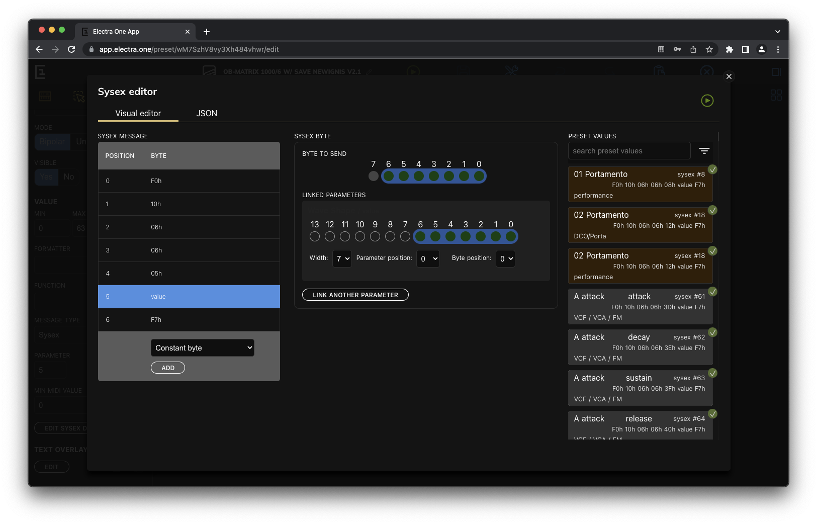

Sysex
SysEx MIDI message type is used to send templated MIDI SysEx messages. Users are allowed to specify an array of bytes that will be sent whenever the Control’s value is changed. The fact that the message is templated means that users are not restricted to sending constant bytes only, instead, they can insert Variable, Checksum, Parameter placeholders to the message. The placeholders will be transformed to values at the time of sending the templated SysEx MIDI message. More detailed information about SysEx templates can be found in Writing SysEx templates.

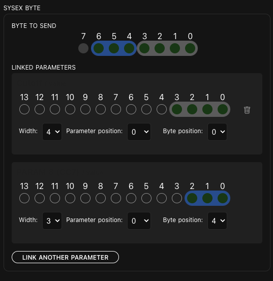

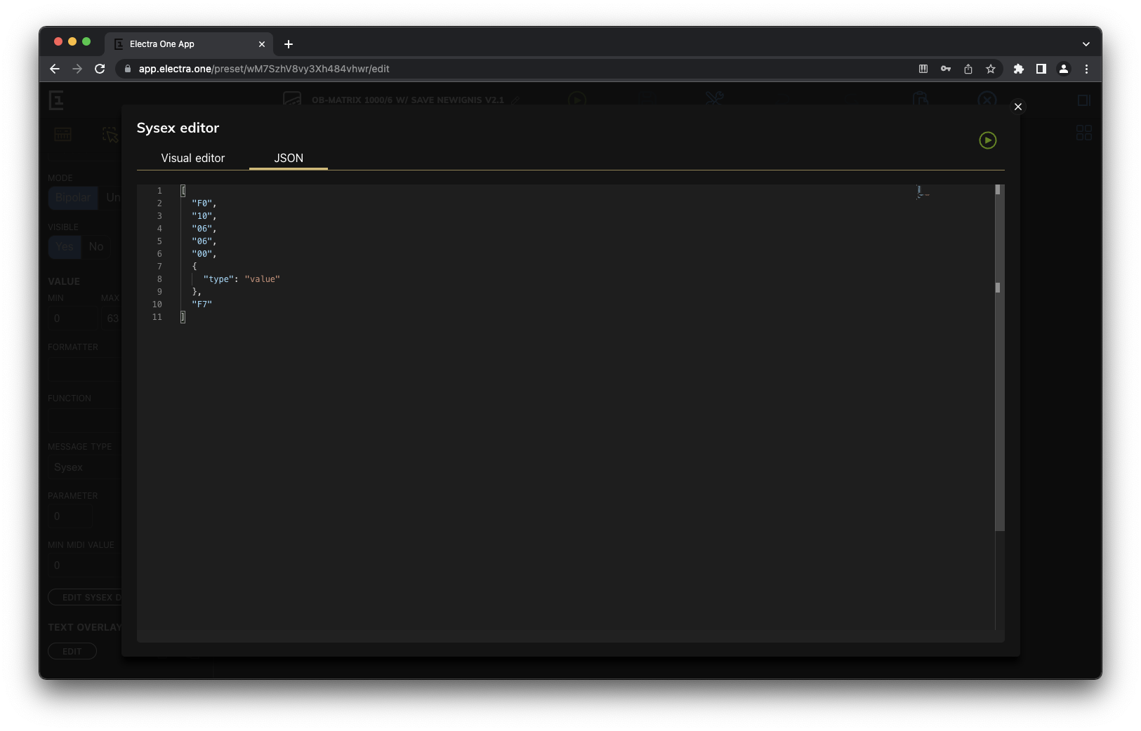

Edit Sysex Data
The Edit Sysex Data button opens a Sysex Template editor, a tool to create sequences of Sysex bytes with message values and Lua function calls included in them. The Sysex editor is described further below in this document.

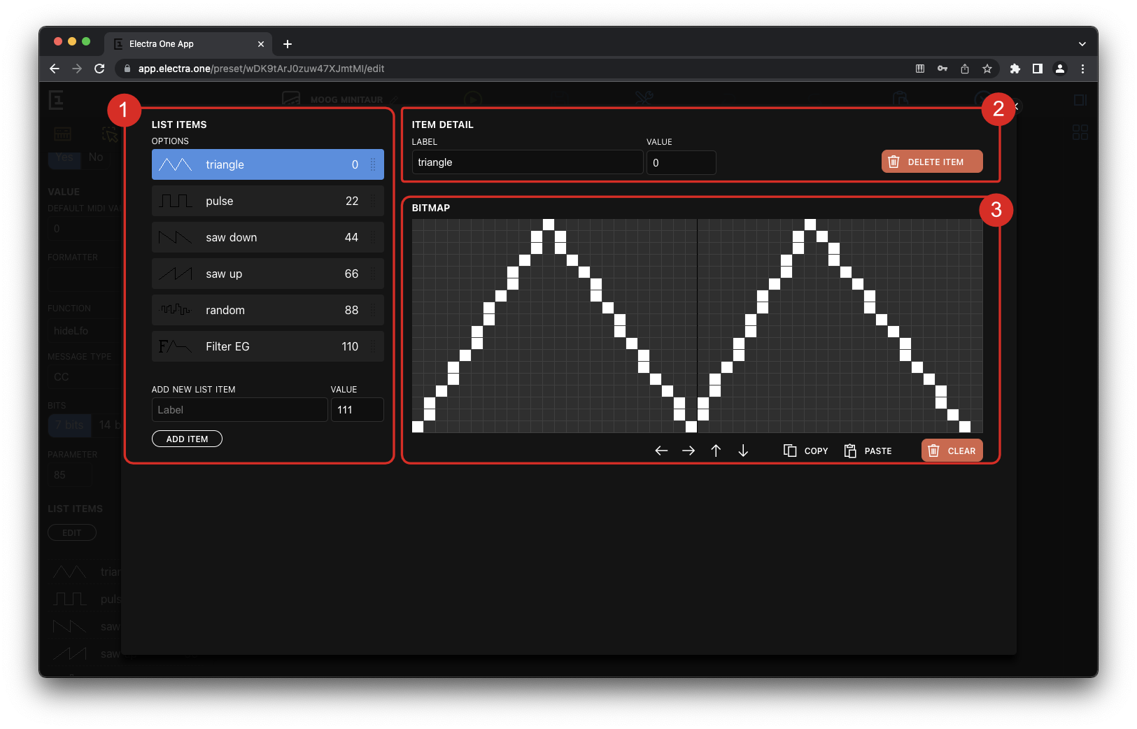

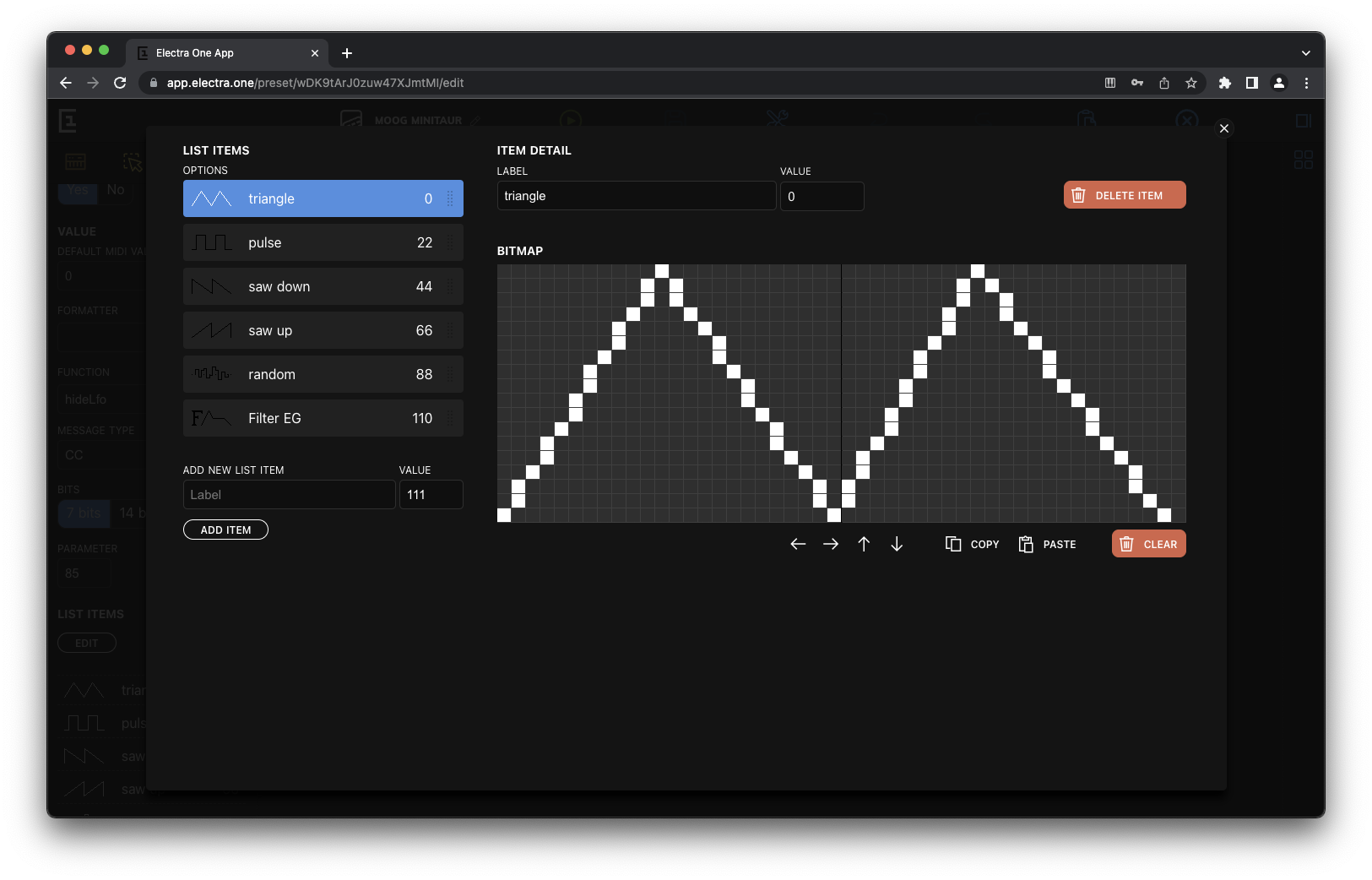

List items / Overlays
The List items / Overlays are text labels that can be assigned to specific values of fader and lists. List items are required to be used with List Controls. They define the actual entries on the list. Overlays are used for faders. Detailed information about List items / Overlay editor is described further below in this document.
Overlay list

Groups are meant to improve the visual layout of the preset and give it more structure. They can be used to make collections of Controls that are related to a specific type of parameters, for example, parameters of VCF section. Groups, however, do not impose any functionality. It is fully up to users how the groups will be used.
Group
To add a group, drag it from the Repository panel on to the Grid.
Group
Each group can be customized to suit your needs. The following can be adjusted:
  • Name of the group
  • Color
  • Width of the group
Tips
The size of the group can be changed by dragging the corners of the group directly on the Grid.
Group

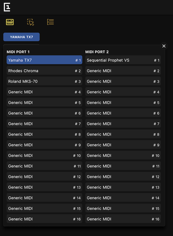

Devices
As it is important to understand the concept of devices, their meaning is fully described in a separate chapter of this User Guide. The following paragraphs just describe how to manage devices in the Preset editor.
The new controls are always picked from the Repository panel in the context of currently selected device. The currently selected device can be seen at the top of the Repository panel. All Controls you pick and place on the grid will be always associated with that device.
Device in the sidebar
If your preset uses more than one device, you can switch between them, by clicking the device name in the sidebar. A list of all available devices will be shown. You can choose the device that you want to work with.
Device list

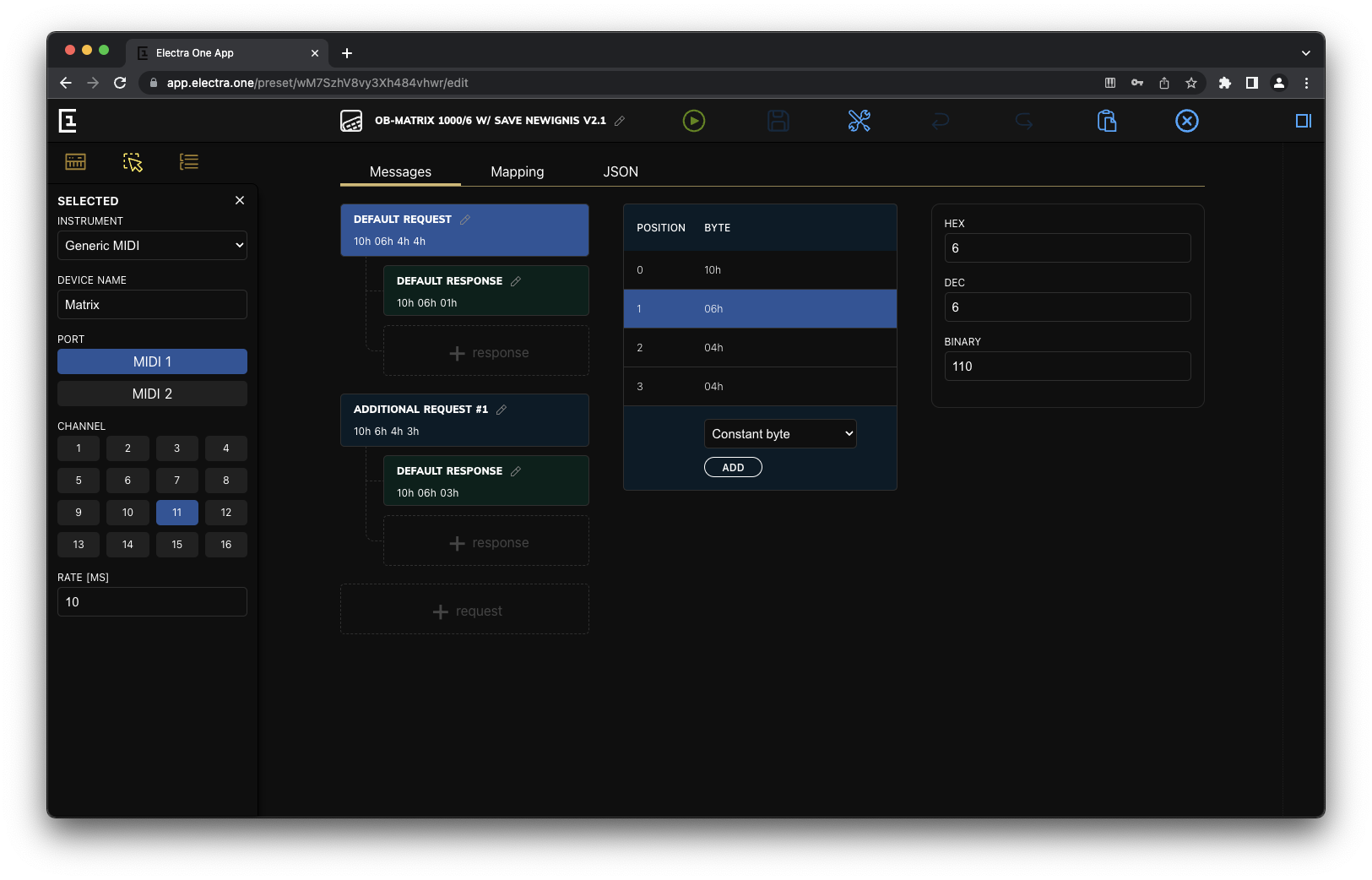

If you need to adjust the settings of a device, for example when the MIDI channel of the device was changed, click the Edit device icon in the device section. The device details will be shown.
Device detail
You can set here:
  • Name of the device
  • MIDI port
  • MIDI channel
Users, who wish to create a preset that supports exchange of Patch data between the Electra One controller and the MIDI device, can use the Patch editor in the main part of the device edit window.

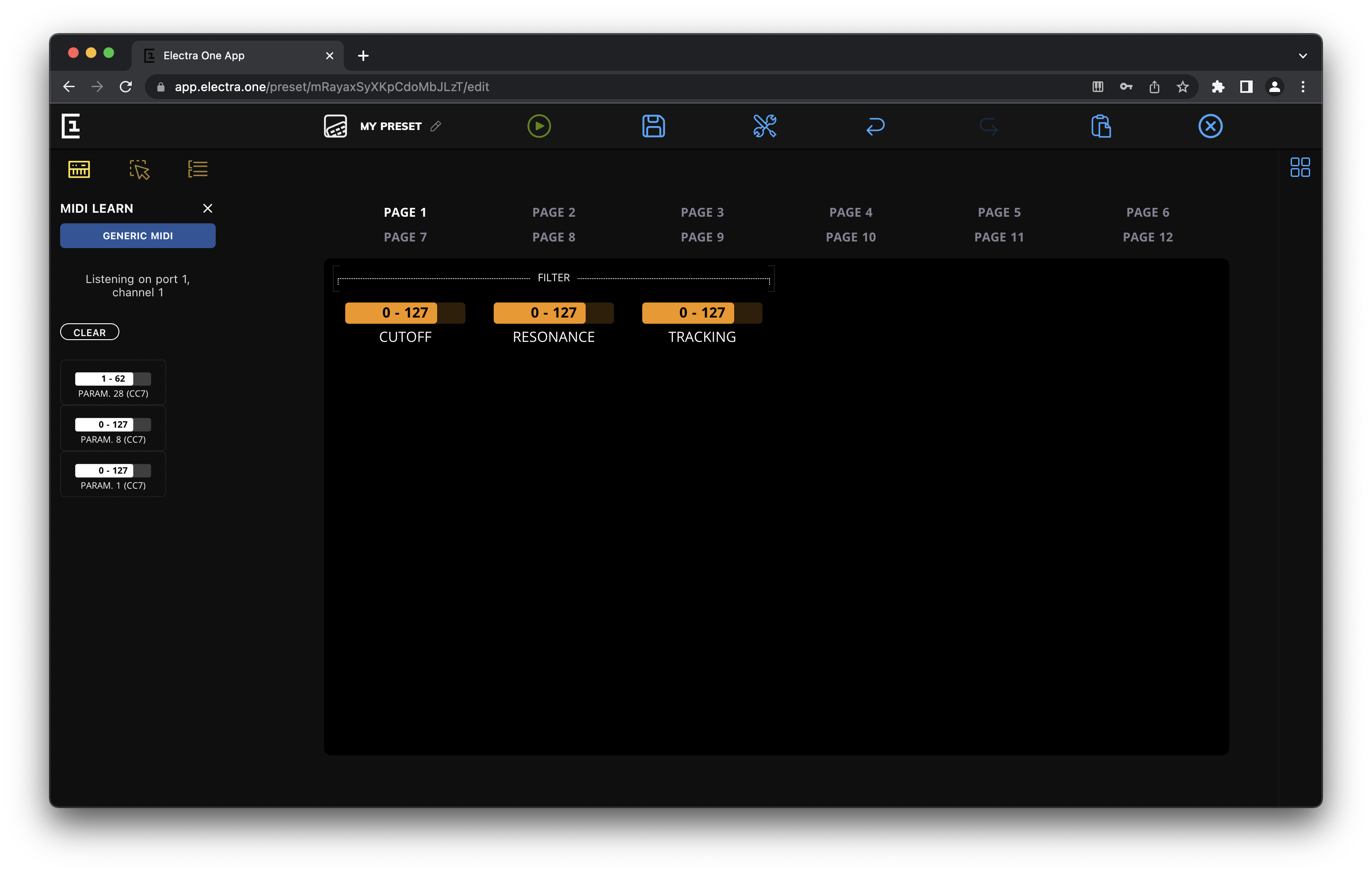

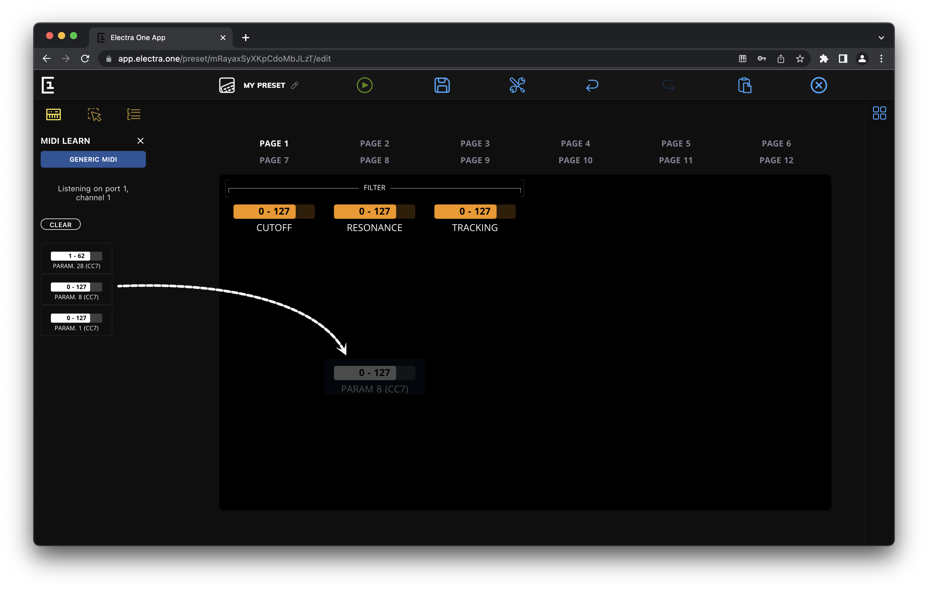

MIDI learn
The MIDI learn function is another tool that makes the preset development less tedious. The MIDI Learn is activated by clicking the MIDI Learn (microphone) icon.
MIDI learn button
Enabling the MIDI learn switches Electra One controller to a special mode when it listens to the incoming MIDI data and reports it to the editor. If the MIDI message matches currently selected devices (MIDI port and MIDI channel), a new Control with a corresponding MIDI message is created and shown in the MIDI learn panel.
The MIDI learn icon is pulsating when the MIDI learn is enabled. Note, Electra does not process MIDI messages in an ordinary way when it is in the MIDI learn mode. It merely collects the MIDI learn information for the Preset editor.
MIDI learn listening
The best approach to let Electra One controller and the editor to understand the MIDI implementation of your instrument is to twist the knobs of the instrument for various parameters while the MIDI learn is enabled.
Twisting the knob
That way MIDI learned Controls are created for each parameter and shown in the MIDI learn panel. The MIDI learn does not detect MIDI message type and parameter number only, it can also detect the minimum and the maximum MIDI value.
Tips
Always try to twist the knob all the way to the left and then to the right. That way Electra One will be able to detect the full range of the values of given parameter.
The Controls collected in the MIDI learn panel can be dragged on to the grid as any other Control on the Repository panel. The CLEAR button removes all MIDI learned Controls from the sidebar so that you can start the process of learning all over again.
MIDI learn drag and drop

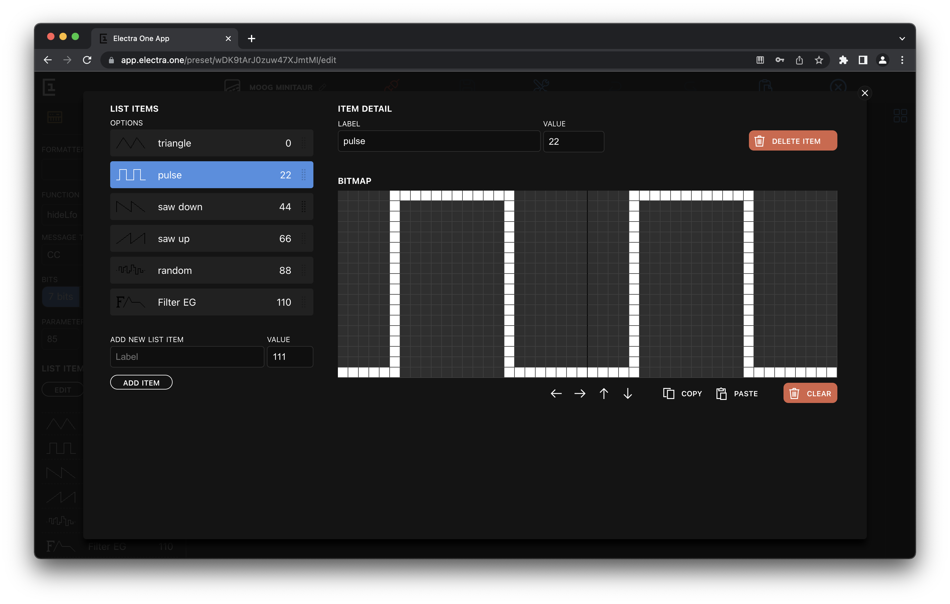

Bitmap editor
A bitmap image can be optionally assigned to a list item. Such an image is displayed instead of the text label wherever it is possible.
Overlay Editor Bitmap
The bitmap images can be drawn using the mouse as a painting tool. White dots represent dots that will be displayed on the controller.
Images can be copied and pasted to other list entries. The arrow buttons allow moving the image around on the grid.
The CLEAR button, clears all drawings. It does not, however, delete the list item.

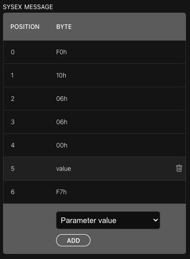

Sysex message
The Sysex messages is a list of individual bytes of the Sysex message to send out. Each row represents one byte of the Sysex message. New bytes chan be added by choosing a byte type and clicking the ADD button.
Sysex Editor bytes
The F0h and F7h Sysex bytes may be included in the beginning and end of the Sysex message. If they are not present, Electra One controller will add them automatically when sending the message.
Clicking on the Bin icon removes the byte from the Sysex message.
When the byte record is clicked, it becomes selected and the detailed information about the byte is shown on the right side of the window.
There are four types of bytes to be added to Sysex messages:
  1. Constant numbers
  2. Parameter values
  3. Lua function calls
  4. Checksum calculations
Each byte type comes with different editor in the byte detail section

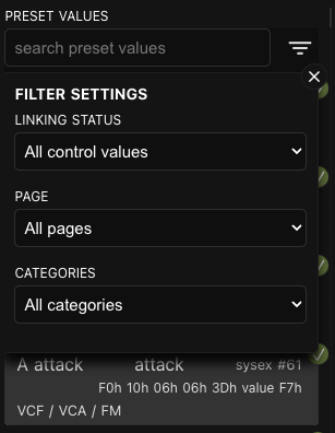

Preset parameter value list
The preset parameter list is used to select the parameters to be linked to the Sysex byte bits. Users use the list to find the parameter they wish to work with. The parameter is selected by clicking on it. Once the parameter is selected, all the work of linking the parameter bits to the Sysex byte is done using that selected parameter.
The list provides information about:
  • The name of the Control where the parameter is used.
  • The name of the Value within the Control where the parameter is used, eg. Sustain for envelope.
  • The name of the Page where the Control is located.
  • The name of the category that the Control has assigned.
  • Information about the MIDI messages associated with the parameter.
  • Information whether or not the parameter value is used in the Patch parsing (the check off mark). Detailed information about the Patch parsing can be found further below in this document.
Sysex Editor value

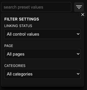

The list of parameter values can be filtered to make it easier to find the parameter values.
Sysex Editor value

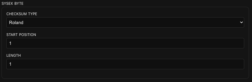

The checksum calculates the Sysex byte value using one of the well-known checksum calculation algorithms.
In order to calculate the checksum user must tell Electra One controller the position of the first byte of the block of bytes used for the checksum calculation and the total length of the block of bytes.
Checksum type
A list of all possible checksum calculation algorithms.
Start position
The position of the first byte of the block of Sysex bytes to be used for the checksum calculation. The position 1 corresponds to the first byte after the F0h leading byte.
Length
Total number of bytes to be included in the calculation.
Sysex Editor checkum

Patch Editor request

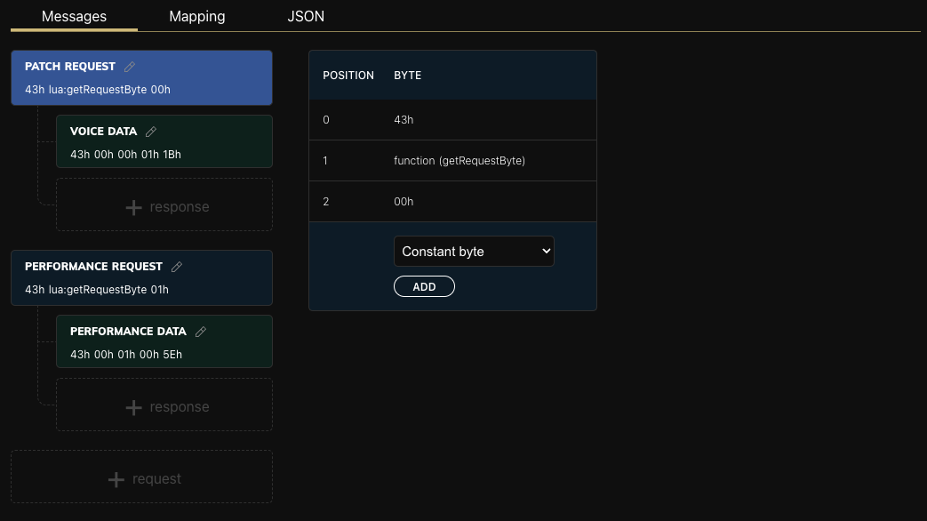

The Sysex communication is based on protocol of exchanging Sysex data messages in request - response manner. It means that the MIDI device responds with a Sysex data response upon receiving a Sysex request. There can be, of course, situations when a Sysex request just makes changes in the MIDI device and the device does not respond with any response. There are also situations when a MIDI device sends a response even if there was not any Sysex request sent to it, for example upon a user action, such is pressing a button on the MIDI device's panel.
The Patch editor is built around the idea of defining the Sysex requests and their responses. They are referred as to Messages in the Patch editor.
The messages
The messages can be organized in hierarchical structure, where one request may have none, one, or multiple responses.

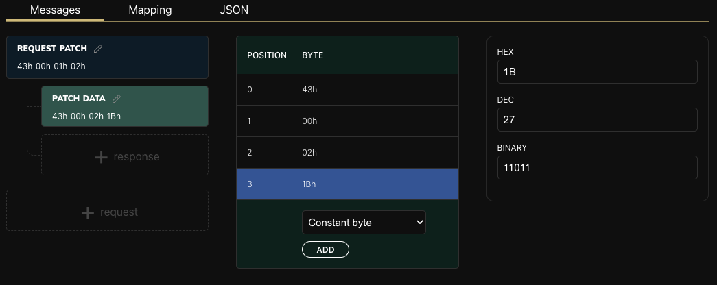

The request
The request is a Sysex message composed of constant or dynamically calculated bytes. The requests are sent out when the [PATCH REQUEST] button is pressed on the Electra One controller or programatically with Lua functions, see the Patch section of the Lua Extension documentation.
Patch Editor request detail
In the Patch editor, the request always has a name and it is associated with a Sysex message. New requests can (be):
  • Added with the + Request button.
  • Deleted with the Bin icon.
  • Have name edited by clicking the Edit icon.
The Sysex message editor is identical with the one used in the Sysex editor. It allows users to enter constant bytes in the Hexadecimal, Decimal, or Binary format.
The Lua functions can be be used as well. When Lua function is used, it is expected to return a byte value that will be send as part of the request Sysex message. For more information about Lua functions to generate Sysex bytes, visit Sysex byte functions of the Preset Lua Extension guide.

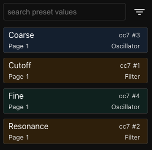

The preset parameter list is used to select the parameters to be associated with the response Sysex byte bits. Users use the list to find the parameter they wish to associated with the Sysex byte. The parameter is selected by clicking on it. Once the parameter is selected, all the work of linking the Sysex byte bits is done using that selected parameter.
  • Information whether or not the parameter value is already associated with any byte of the response Sysex message (the check off mark)
The list of parameter value mappings is shown when a parameter value is selected with the mouse:

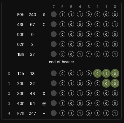

The Response Sysex message allows user to review the Sysex messages received from the MIDI devices - captured messages.
The Response Sysex message is a view of currently selected captured message. If there are not any captured messages available, the response header bytes are shown instead, and the user is advised to enable the MIDI learn function by clicking the START LISTENING... button.
The data bytes of captured messages are shown only if selected captured message matches the response header bytes.

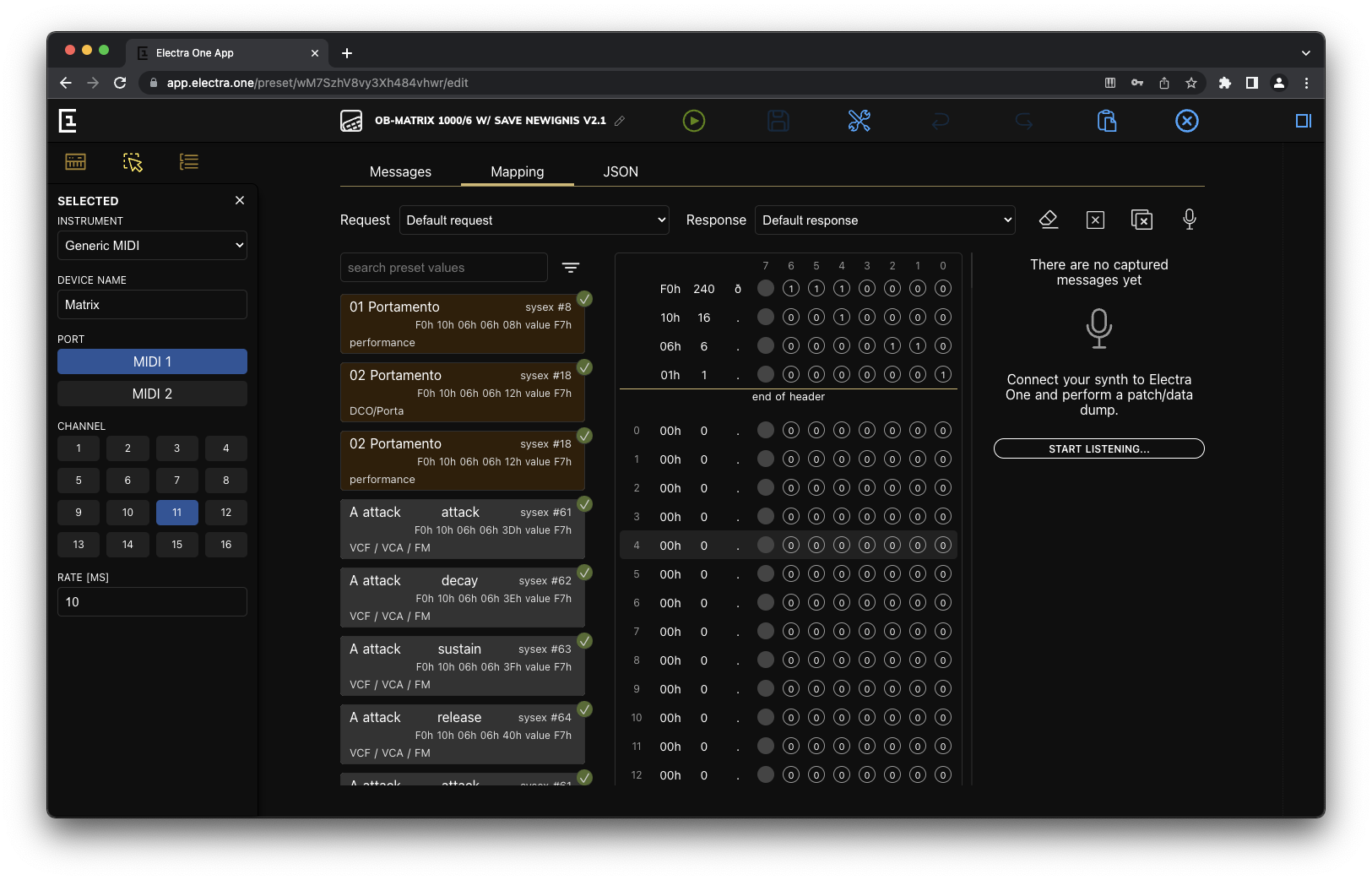

Captured messages
The right-most section of the Mapping provides a list of all Sysex messages received from the MIDI device.
When there have not been any captured messages received yet, the Patch editor instructs the user to enable the MIDI learn by clicking the START LISTENING... button.
When a captured message is selected and its leading bytes match the response header, the data bytes of the captured message are shown in the Response Sysex message section in the middle of the window.

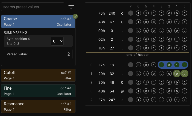

Mapping the parameters
Once the Response Sysex message is successfully matched and shown, a process of assigning the Sysex bytes values to preset parameter values can be started.
Start with choosing the parameter you want to map:
Locate corresponding bits in the Sysex message and assign them to the mapping rule by clicking on each bit. All consecutive bits will form one mapping rule:
Should the parameter value be composed of bits from more than one Sysex byte, mark all bits in these bytes too.
Tips

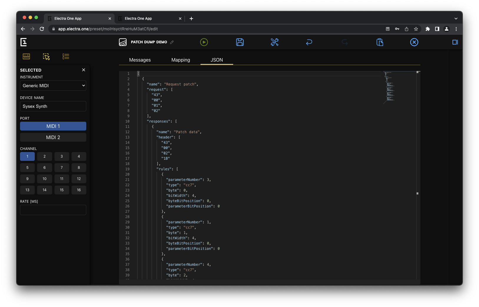

JSON editor
Users may opt to define their Patch parsing definition using the JSON formatted source code. The JSON editor allows editing of the raw JSON file. The work in the visual and JSON editor can be freely combined.
Detailed information about developing Patch parsing mappings in JSON format can be found in Parsing Sysex messages document.

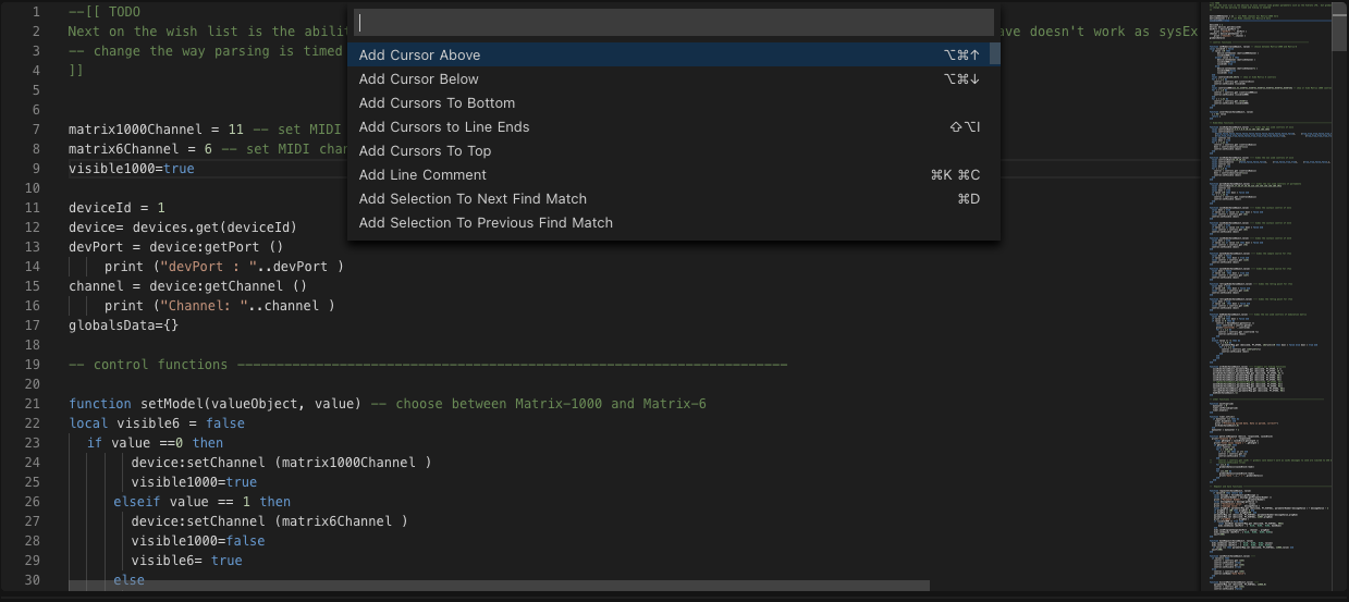

Lua Editor

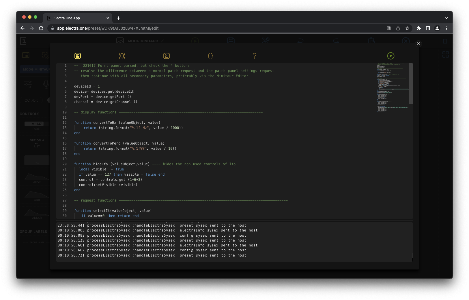

The Lua editor is a programmer-grade text editor for editing Electra One Extension Lua script.
Lua editor
The editor consists of two sections. The editor and the log window. The editor is in the upper part while the log window is below the editor. There is a handle to resize the editor window between the editor and log window.
Lua editor
The editor has wide variety of commands mapped to keyboard shortcuts. All available commands can be shown by pressing the F1 key or right-clicking the editor window and selecting the Command palette.
Lua editor
The log window shows a stream of log messages from the hardware controller. When mouse pointer is hovered above the log window an input field on filtering and clearing the log messages is shown.
Lua editor

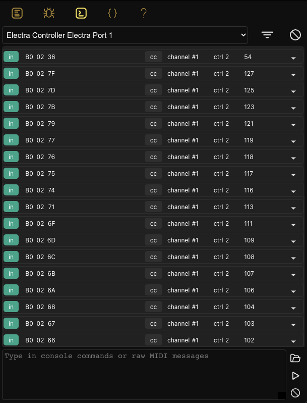

MIDI Console
The MIDI Console is a tool to send MIDI messages and monitor MIDI communication between the Preset editor and the MIDI devices, including Electra One controller.
MIDI Console
The MIDI Console consists of three sections:
  • Menu
  • Monitor window
  • Message prompt
Menu
The menu allows user to select the MIDI device / port to interact with and filter and clear MIDI messages in the monitor window.
MIDI Console
Filter
MIDI Console
Configures the MIDI message filter. MIDI messages that are not chosen are completely ignored by the MIDI console.
Clear
MIDI Console
Clears the content of the Monitor window.
Message prompt
The message prompt is used to enter the MIDI messages, MIDI commands, and load files with MIDI messages.
MIDI Console
The MIDI messages can be entered either as MIDI command with the syntax inspired by the sendmidi tool, or as raw strings of MIDI data.
There are three actions associated with the Message prompt:
Load message file
MIDI Console
Loads raw MIDI data from a file and executes them.
Send the message
MIDI Console
Sends MIDI messages currently present in the Message prompt to selected MIDI device. Clicking the Send button has the same function as pressing the Enter key.
Clear the Message prompt
MIDI Console
Clears content of the Message prompt.

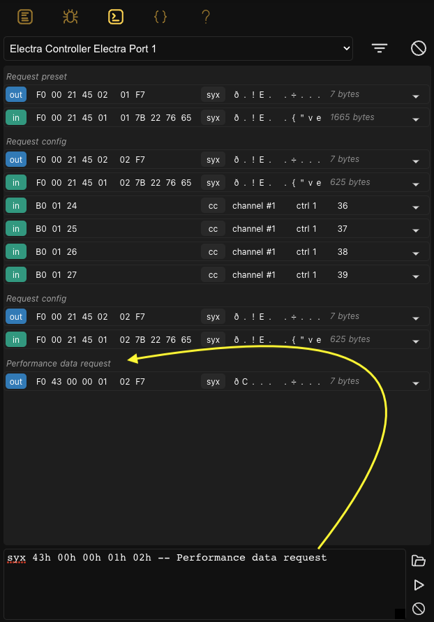

When lua style comment is added at the end of the MIDI console command, it will be shown in the stream of MIDI messages in the Monitor window.
eg.
syx 43h 00h 00h 01h 02h -- Performance data request will result in:
