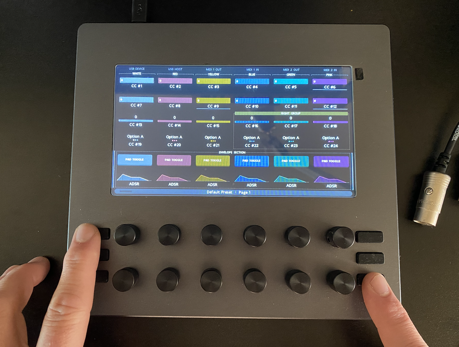

3. Switch to the bootloader mode
When done correctly, the bootloader menu page will be shown:

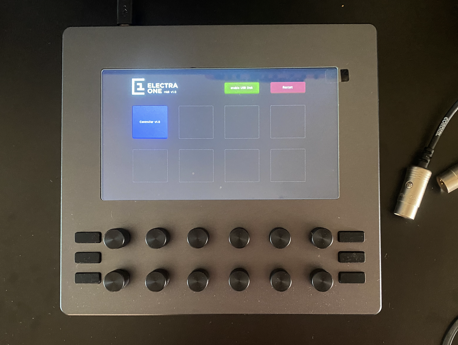

4. Enable the USB Disk option
Tap the green button that says "Enable USB Disk" on the controller screen. After tapping it, the button will display "USB Disk enabled". Your Electra One controller should now be recognized as a USB disk named "ELECTRA" on your computer.

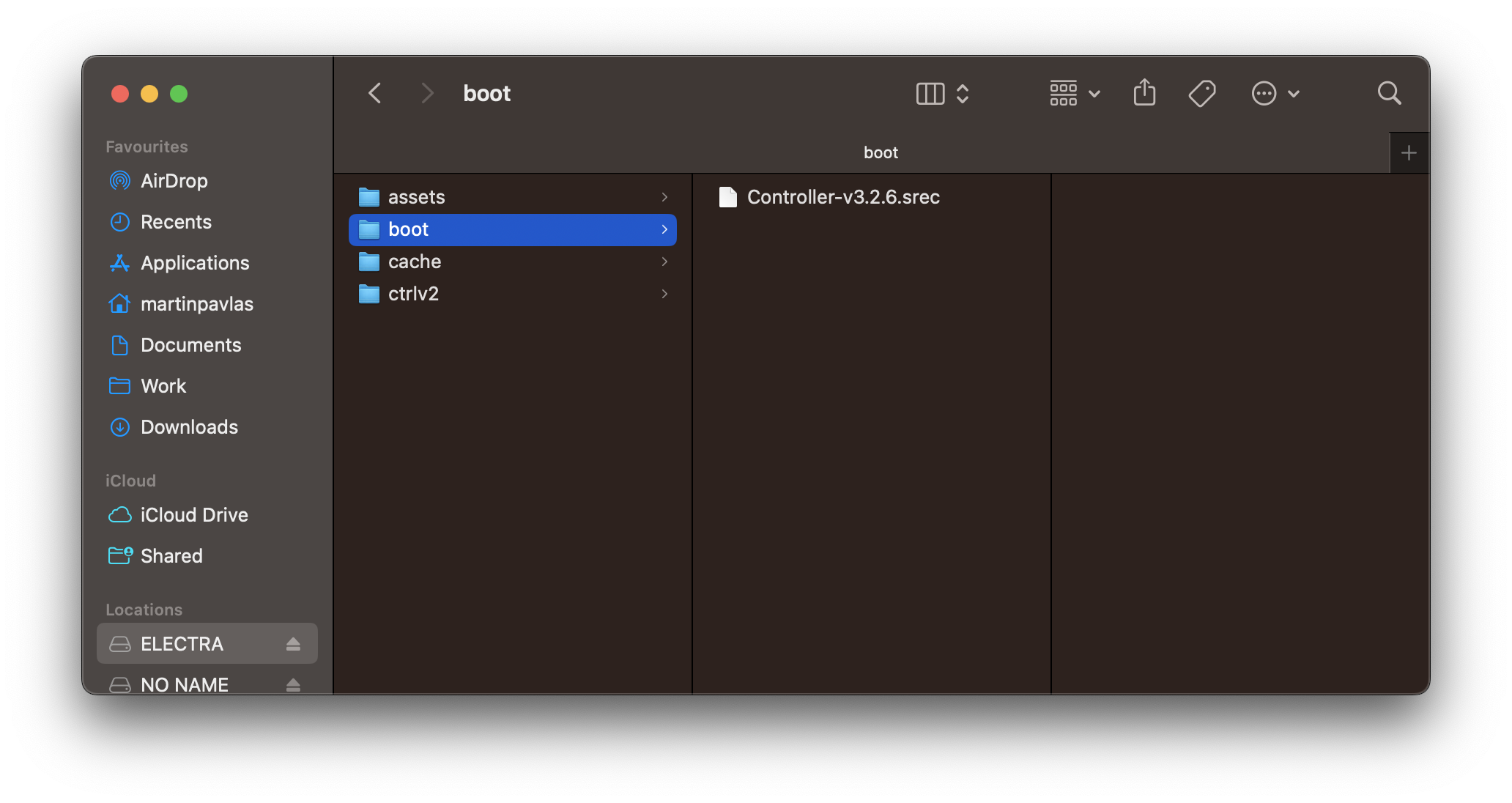

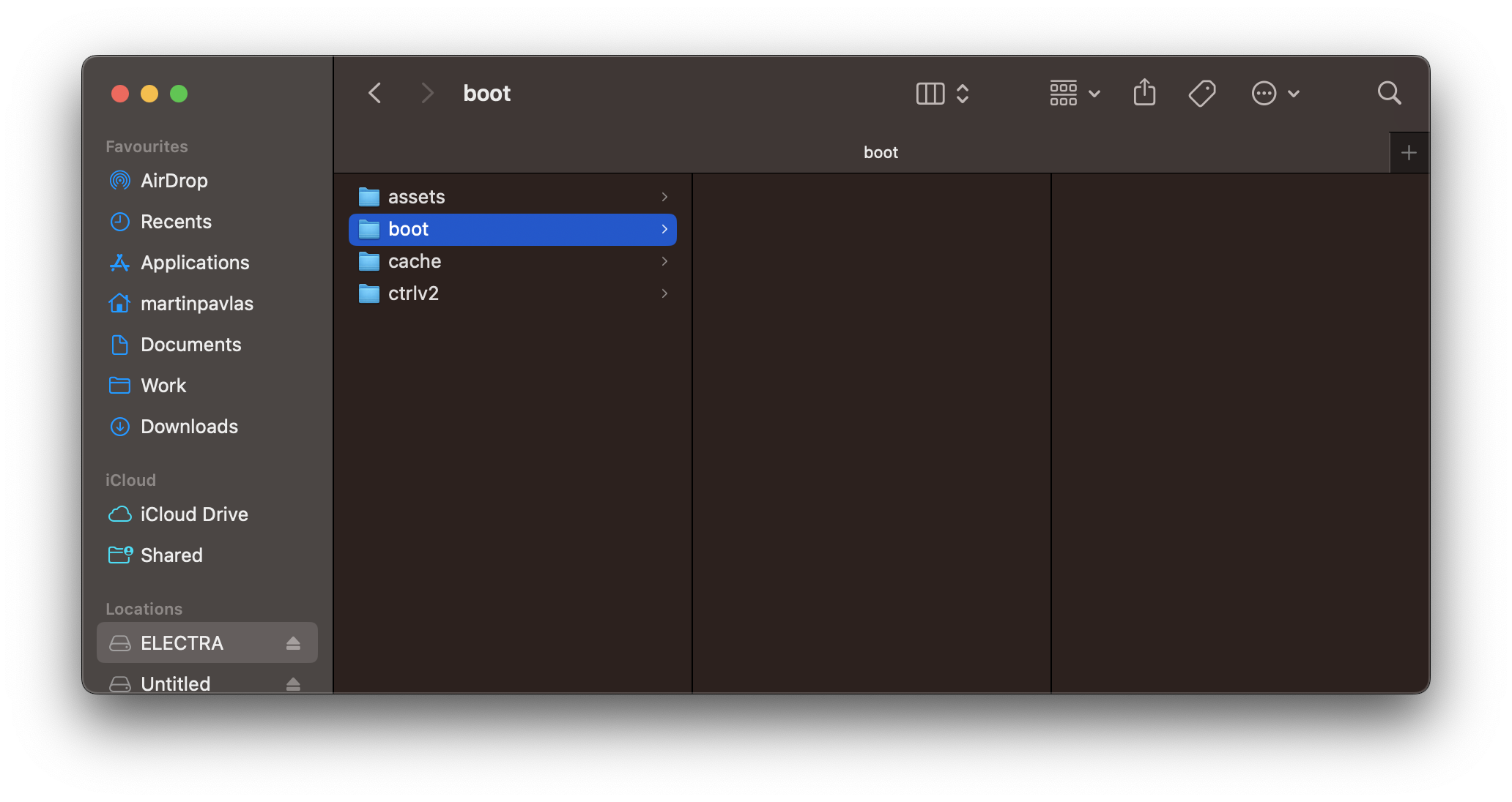

5. Copy the update file to the boot folder
Copy the "Controller-vx.x.x.srec" file that you downloaded in step 1 to the "boot" folder on the Electra One disk. Please be aware that this process may take a moment to complete.
Once the file has finished uploading, close Finder (Mac OS) or File Explorer (Windows), and safely eject the disk.
6. Reload the list of firmware images
After copying the file to the boot folder on the Electra One, press and hold the right-bottom [MENU] button. While keeping the [MENU] button pressed, tap the restart button on the screen.
The bootloader will be restarted and the Controller-vx.x.x firmware will be displayed in the list of firmware images.
7. Apply the update
Tap on the blue tile with the uploaded firmware file, labeled "Controller-vx.x.x".
The firmware update will be initiated, and upon successful completion, the controller will start up and run the new firmware.

  2. Unnecessary and outdated firmware image files can be safely deleted from the boot directory on the ELECTRA disk.
  3. Please ignore files starting with "._", they are created by the MacOS operating system and they cannot be used to update the controller.
