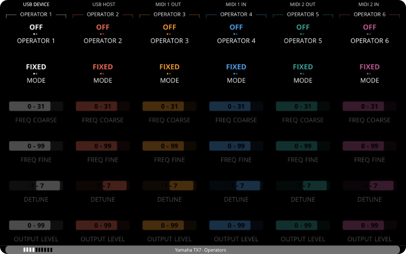

Electra One users create Presets by organizing various Controls to layouts that suit their needs. These layouts are called Presets. Presets are created, edited, and managed in Electra One App and uploaded to Electra One controller over the USB device port. The picture below is an example of one Page of a Preset:
Preset screen
In this example, the Preset consists of a number of Controls used to edit patch parameters of one specific synthesizer. Presets may, however, consist of Controls that are linked to many synthesizers. This allows Electra not to be only a synth programmer but gives you possibility to be in control of the whole rig of gear.

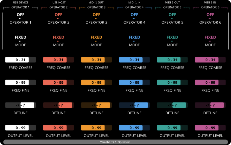

Fader
Faders are ideal for showing and sending continuous ranges of parameter values. A good example of a fader is a cutoff frequency of a filter or an oscillator detune. Turning the knob smoothly changes the current value of the assigned parameter. As you turn the knob corresponding MIDI messages are sent and the fader value is updated on the display.
The value may change within a given minimum and maximum.
Fader control
If the value range minimum is negative, the zero value is placed proportionally within the length of the fader. Positive values are then represented by a fader bar extending to the right, while negative values extend to the left.
Control positive Control negative
Optionally, faders may have Overlay assigned. Overlay replaces specified values with a text label. More on info on overlays is provided below.

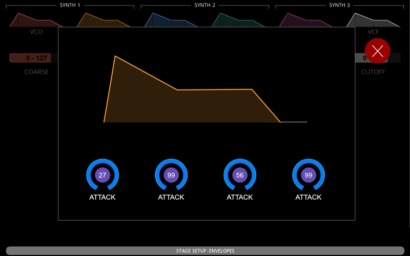

Envelopes
The envelopes are multi-value Controls that greatly improve the visual representation of ADSR and ADR envelopes. They allow users to map their MIDI parameters to individual segments of envelopes. Electra One can then visualize the shape of the envelope whenever the incoming MIDI data modifies it or when the user changes the values with knobs.
ADSR control
The following types of envelopes are supported:
  • ADSR
  • ADR
  • ADDSR
It is possible to specify which value will be assigned to the knob by default. For example, you may choose Attack being controlled by the knob. It is possible, however, to change this assignment on the fly when working with the preset. It means one knob can be used to change all values of the envelope.
The detail window of an envelope control provides access to all parameters with knobs. The knobs are remapped so that all parameters can be changed with knobs.
ADSR detail
