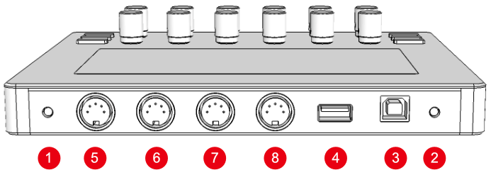

Back panel and connectors
The back panel serves two purposes. It is the place to connect your gear and the computer. There are also buttons to reset Electra and initiate the firmware update.
Electra back panel
  1. [UPDATE] button
  2. [RESET] button
  3. <USB DEVICE> port
  4. <USB HOST> port
  5. <MIDI 2 IN> port
  6. <MIDI 2 OUT> port
  7. <MIDI 1 IN> port
  8. <MIDI 1 OUT> port
Ports <MIDI 1 OUT>, <MIDI 1 IN>, <MIDI 2 OUT>, <MIDI 2 IN> are often referred as to <MIDI IO>

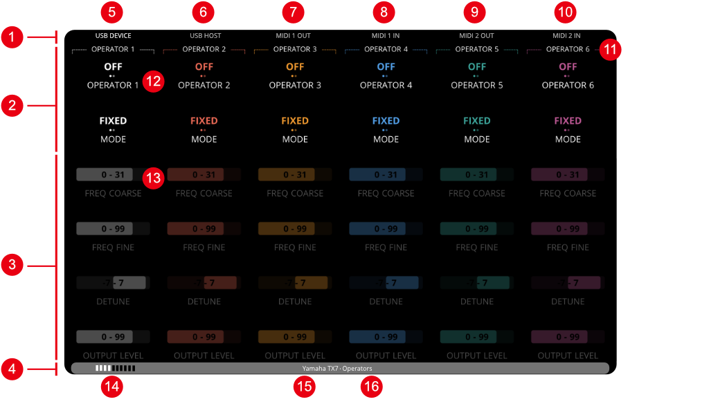

Display layout
The display is the place where all the magic happens. It displays controls assigned to the synthesizer parameters as defined in the currently loaded preset. The display also provides information about activity on the ports, currently selected preset and page, and memory usage. The controls are organized in 6 x 6 grid, giving you access to 36 controls per page.
  1. Status bar with MIDI port activity indicators
  2. Active section of controls
  3. Inactive sections of controls
  4. Bottom bar with the preset name and current page name
  5. Indicator of activity on <USB DEVICE> port
  6. Devices connected to <USB HOST> port and indicator of activity
  7. Indicator of activity on <MIDI 1 OUT> port
  8. Indicator of activity on <MIDI 1 IN> port
  9. Indicator of activity on <MIDI 2 OUT> port
  10. Indicator of activity on <MIDI 2 IN> port
  11. Group of Controls
  12. List Control
  13. Fader Control
  14. Memory usage
  15. Preset name
  16. Current page name

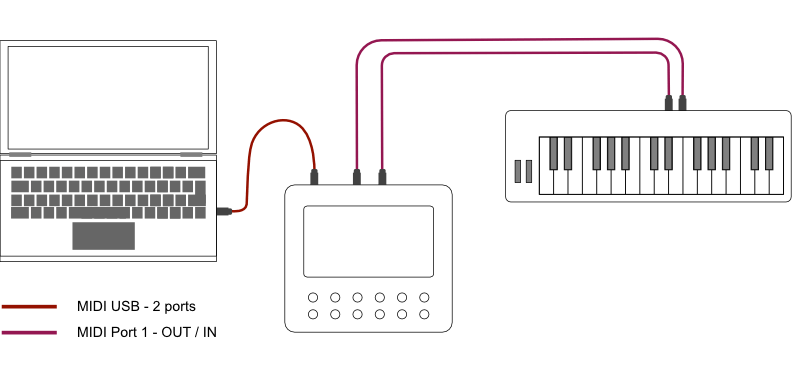

Electra can be connected to your studio setup in many ways. For the start, the following configuration is ideal:
Electra with one synthElectra with one synth diagram
In this setup, Electra can control sound parameters of the synthesizer connected to <MIDI IO> port. You will see Electra' USB Device ports on the connected computers, we refer to them as <USB DEVICE>. These ports can be used to send and receive MIDI messages to and from the synthesizer. It means Electra acts here as a MIDI controller as well as a MIDI USB interface.
There are three USB device ports:
  • Electra Port 1
  • Electra Port 2
  • Electra CTRL
Any MIDI message sent to USB device Port 1 OUT, will be forwarded to <MIDI 1 OUT> port. Any message received on <MIDI 1 IN> port, will be forwarded to USB device Port 1 IN. Ports 2 work in the same way.

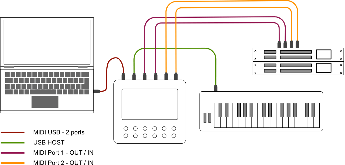

To illustrate Electra's capabilities let's take a look at a more complex setup:
Electra in complex setupElectra in complex setup diagram
Here we connect more gear to the <MIDI IO> ports. Next to that, the Master keyboard is connected to Electra’s <USB HOST> port.
In this setup, you can have full bi-directional control over two hardware synth modules. The MIDI messages generated by the Master keyboard are automatically forwarded to both <MIDI IO> ports and to the <USB DEVICE> ports.
MIDI messages generated by turning the knobs are being merged to the flow of MIDI data according to Electra’s settings. These messages will be sent to both <USB DEVICE> port as well as to <MIDI IO> ports.
