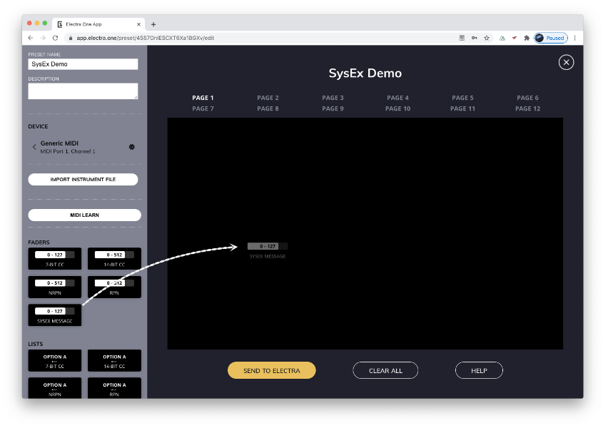

To control a SysEx parameter of your synth, you will need to pick a SysEx message Control from the palette and drag it on the canvas.
Sysex drag and drop

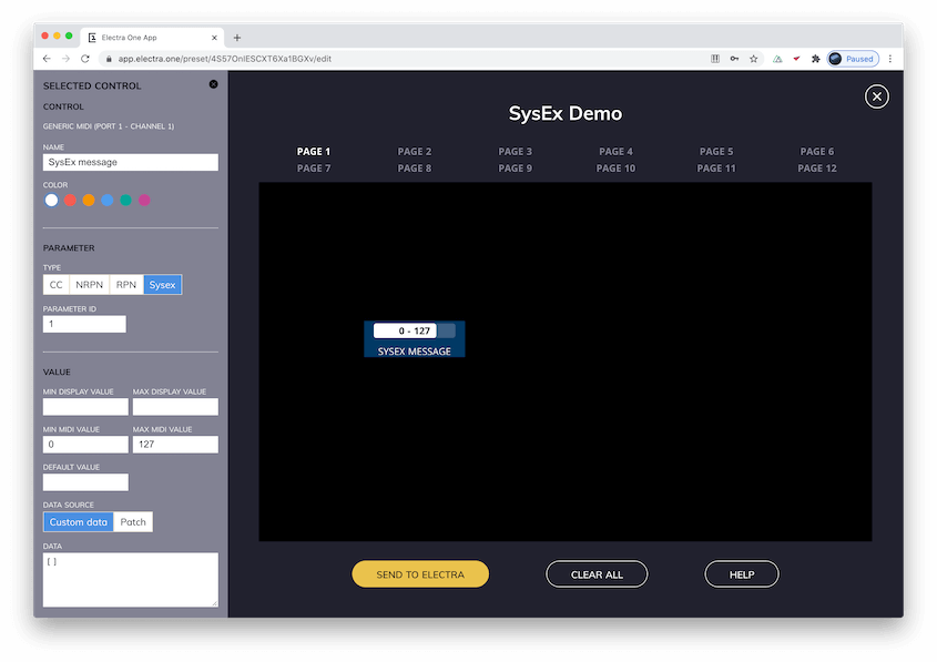

When the SysEx message Control is on the canvas, you can edit its properties in the sidebar.
Sysex drag and drop
There are two attributes specific to the SysEx message Control type:
  1. Data source
  2. Data
Data source
Data source tells Electra One what is the source of the SysEx data. it can be either Custom data or Patch. The Custom data allows you to enter a sequence of SysEx bytes and various variables for each Control individually. The Patch, on the other hand, will use a one patch definition of the device as the template for all your SysEx messages sent to one device.
We will focus on the Custom data only in this tutorial. The topic of using Patch is too complex and will be described in a separate tutorial.
Data
The Data text field is available only when Data source is set to Custom data. The field accepts JSON encoded data that describes the SysEx message. At present time entering the JSON formatted data is the only way of creating a SysEx template.

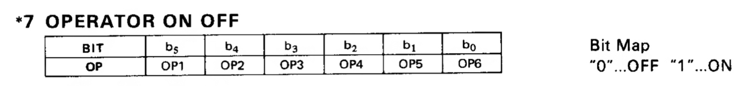

In early MIDI days, the memory of the machines was very limited. Manufacturers often used one SysEx byte to hold several parameter values. A very good example of this is the Operator switches byte of Yamaha DX7. Within this SysEx byte, 6 individual bits express if each of the six voice operators is switched on or off. From what you read above, you know you can address each of those bits by using byteBitPosition and bitWidth rule attributes. The tricky part here is, however, the fact that you always need to provide all six bits. Even if you work just with one operator.
DX7 bits
If you wondered why rules are a JSON array, you might know where we are heading to. This is how you would resolve this pickle in Electra JSON:
