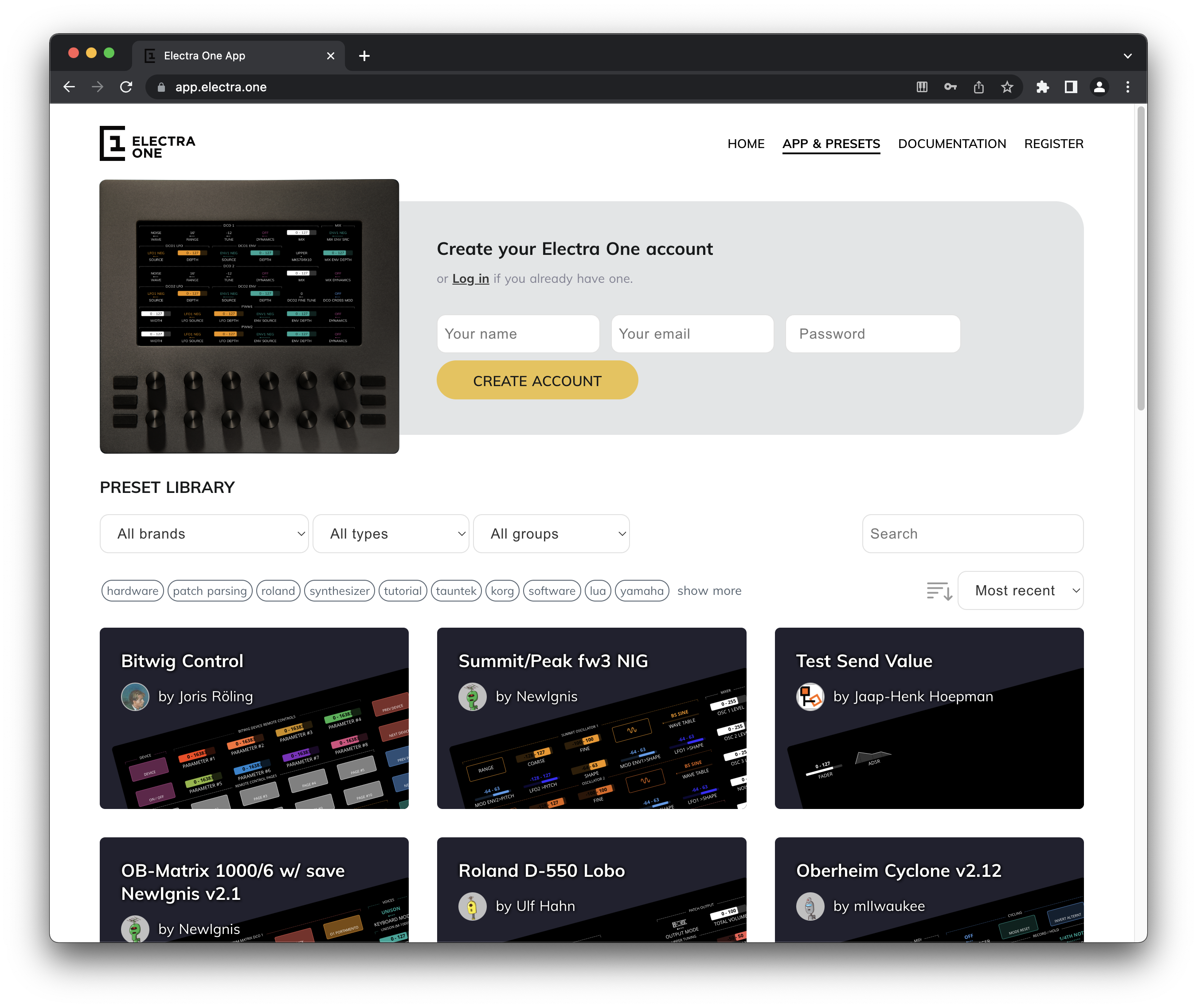

1. Create your Electra One account
Open Chrome or Edge browser and go to https://app.electra.one/register to create your Electra One account. The account will grant you access to the Preset library and the Preset editor.
Web home page

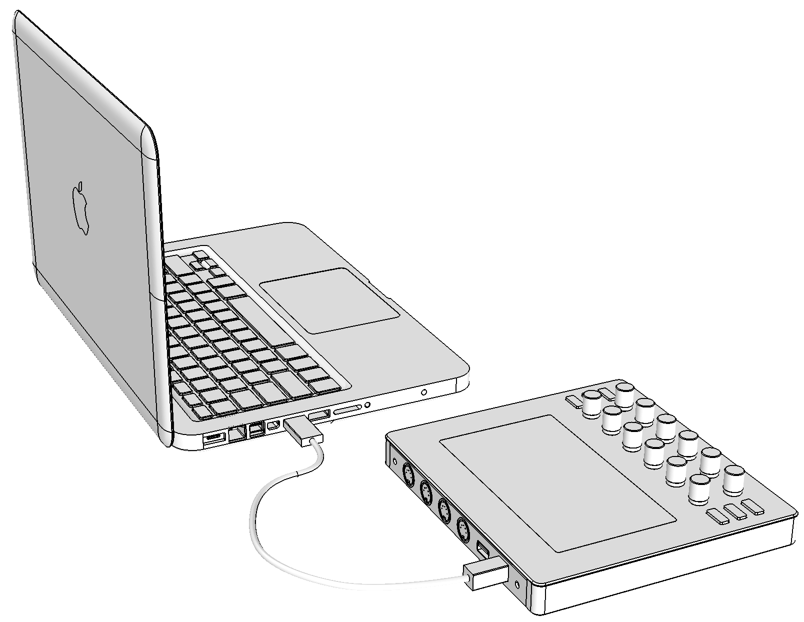

2. Connect your new Electra One controller to a computer
Once you signed in to your new account, use the bundled USB cable to connect the Electra One to your computer's USB port.
Electra with Mac

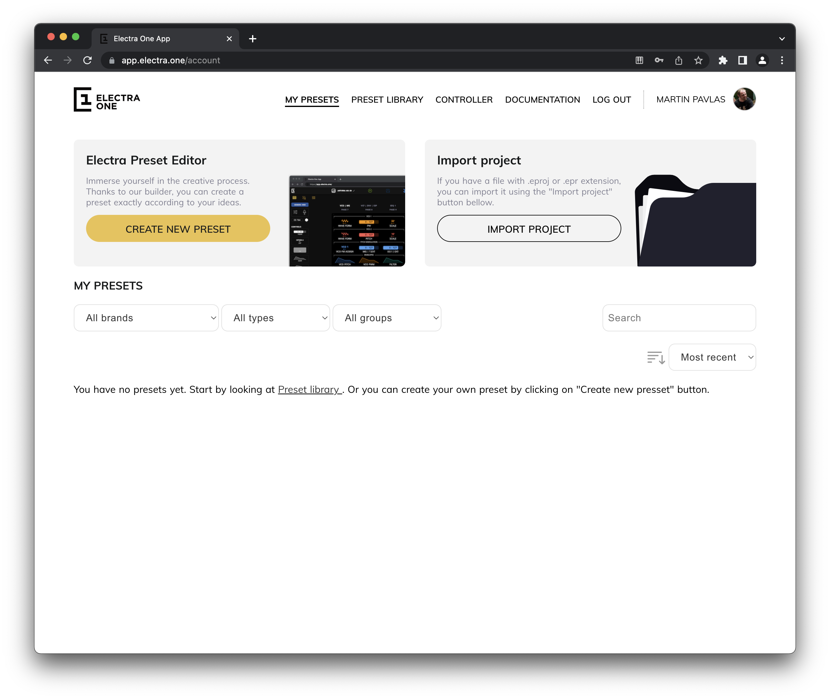

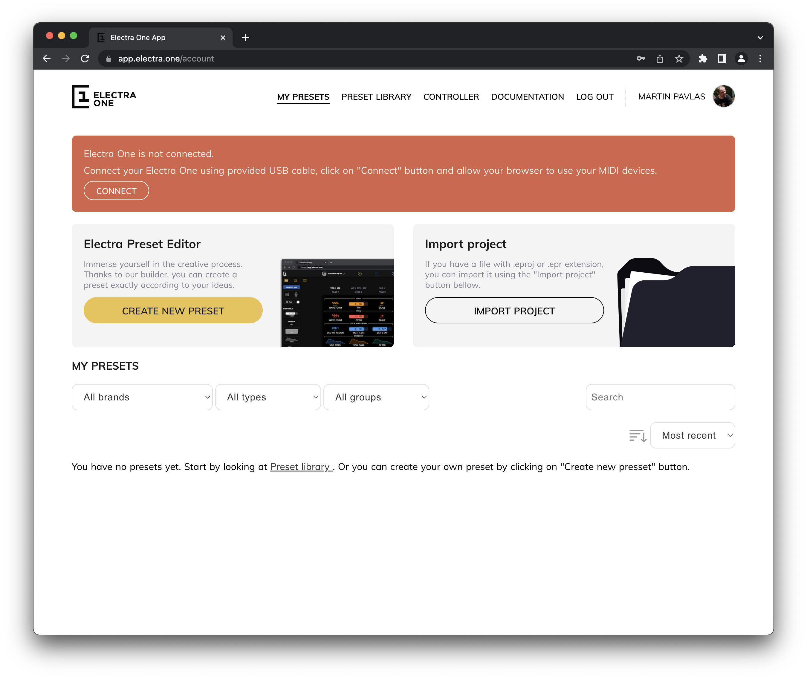

3. Confirm the connection
Confirm that the Electra One controller is connected by clicking the CONNECT button in the web application.

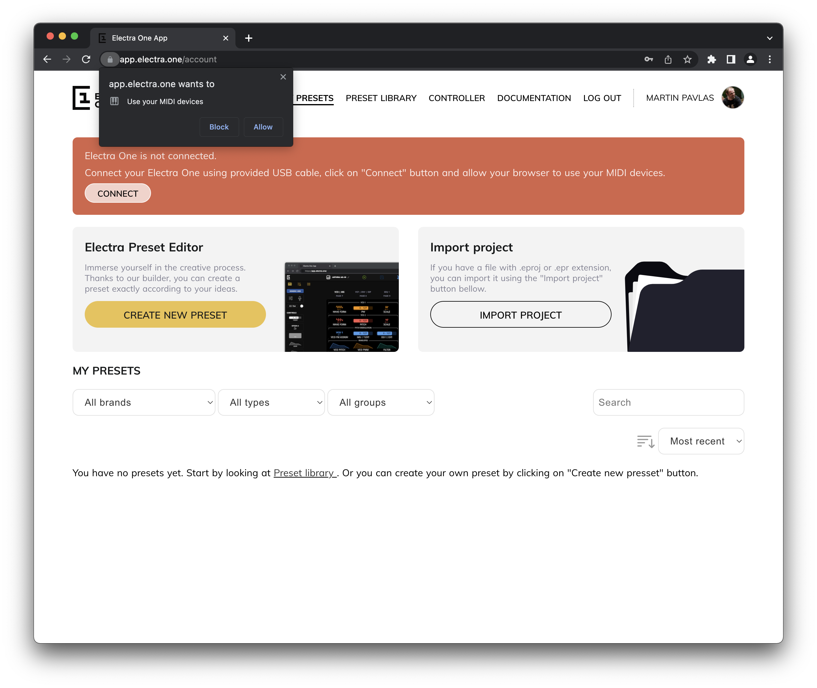

4. Allow use of MIDI devices
If you get a prompt asking about the use of MIDI devices, accept it by clicking ALLOW button. If the use of MIDI devices is not allowed, Electra One controller will not be able to communicate with the browser application.

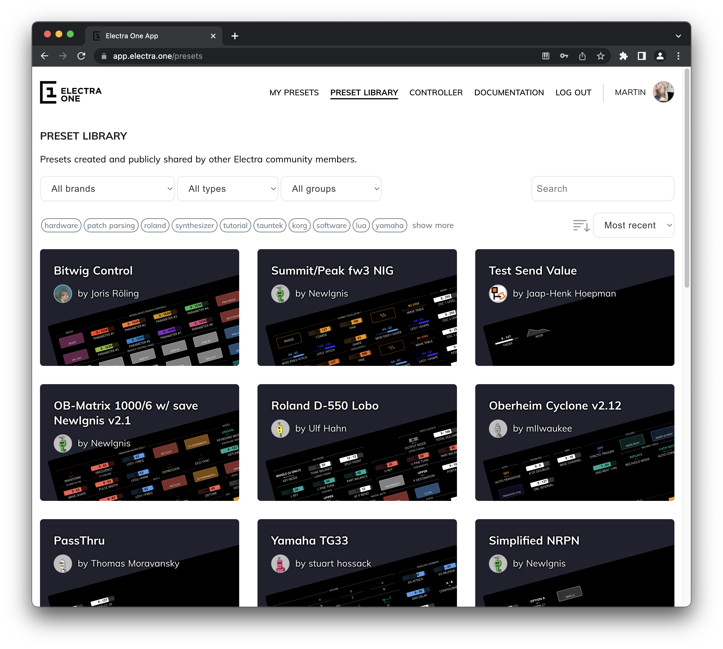

6. Go to the Preset library
Click on the PRESET LIBRARY link in the top menu and pick one of many available presets. Choose a preset you would like to upload to your Electra One controller.
Application preset library

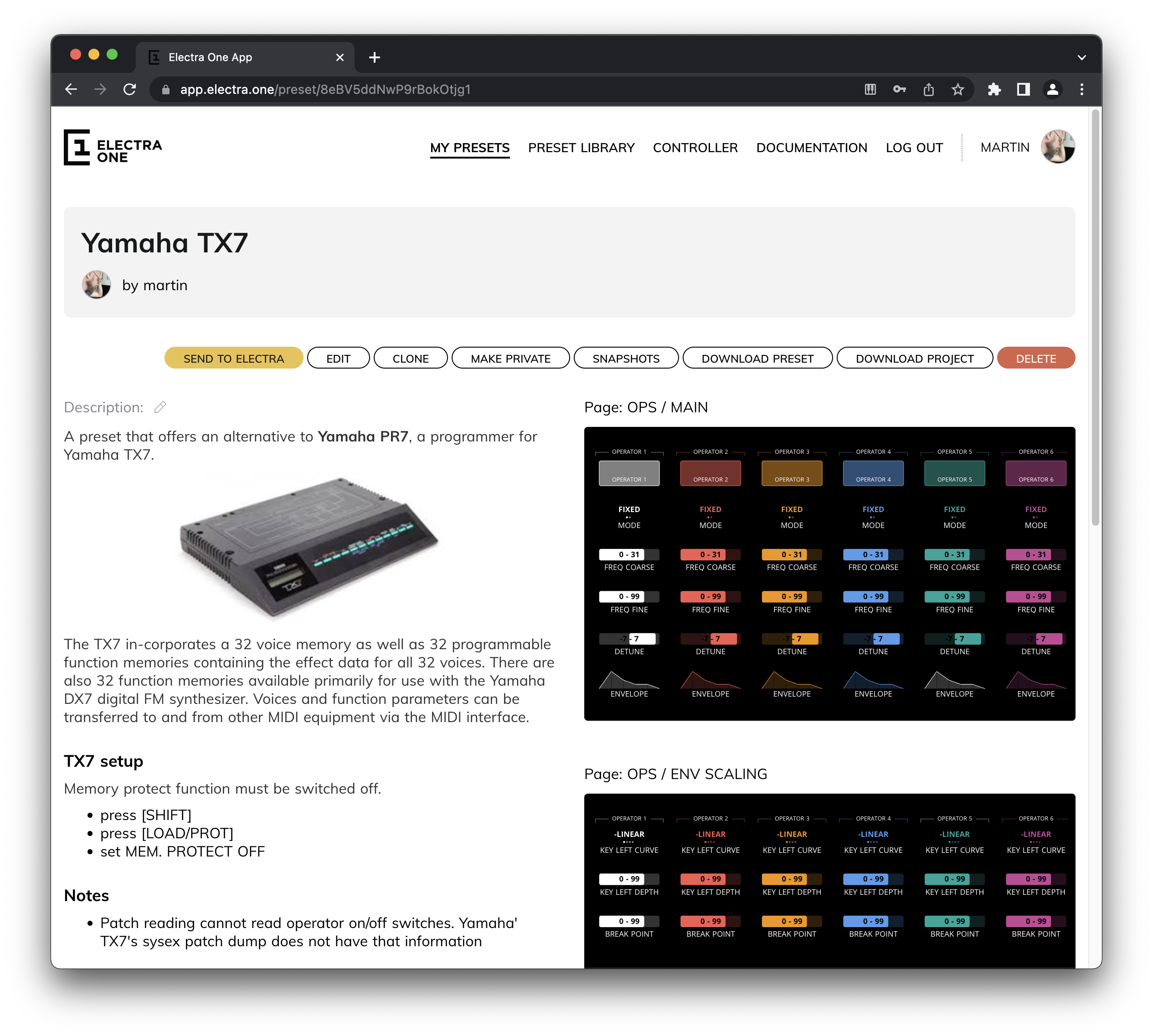

7. Send the preset to your Electra One
Hit the SEND TO ELECTRA button. Et voilà, the preset you have chosen is now loaded in your Electra One MIDI controller and ready to be used !
Application preset detail
If you twist the knobs or use the LCD touch, your Electra One controller will send MIDI data according to the preset definition. To get more familiar with your new MIDI controller, proceed to the next chapter of the User Guide - Hardware overview.
