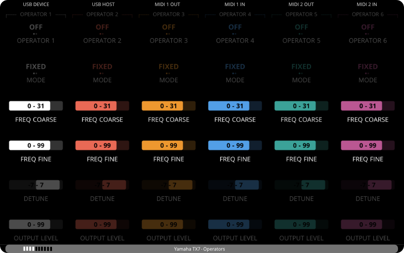

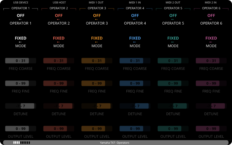

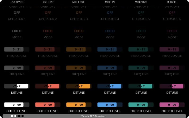

Active section
Electra’s display can show up to 36 Controls on one screen. There are, however, only 12 knobs. To allow the user to easily reach all 36 Controls, the screen is divided into three sections of 12 Controls.
Only one section can be active at the time. The Controls of the active section are connected to the 12 knobs. Turning a knob will cause a change of the value of the corresponding Control.

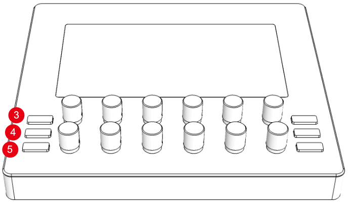

The Active section is selected with the three buttons on the left side of Electra.
Active section buttons
  • Button 3, referred to as [SECTION 1], makes the top section active
  • Button 4, referred to as [SECTION 2], makes the middle section active
  • Button 5, referred to as [SECTION 3], makes the bottom section active
The Active section is always highlighted, while the inactive sections are dimmed. The section highlighting helps users to get oriented on the screen and make a visual connection between the knobs and the controls.
The Active section can be also switched by clicking a Control on the display. The click will activate the section where the Control is located.

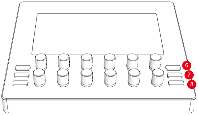

Right side buttons
Right side buttons provide access to presets, preset pages, snapshots, configuration, and to request patches.
Right side buttons
  • Button 6, referred to as [PATCH REQUEST]
  • Button 7, referred to as [SNAPSHOTS]
  • Button 8, referred to as [MENU]

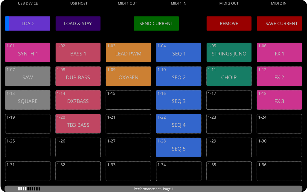

Pressing the [SNAPSHOTS] button will open the Snapshots window. Snapshots are saved sets of preset Control values. The Snapshots window can be closed by pressing the [SNAPSHOTS] again.

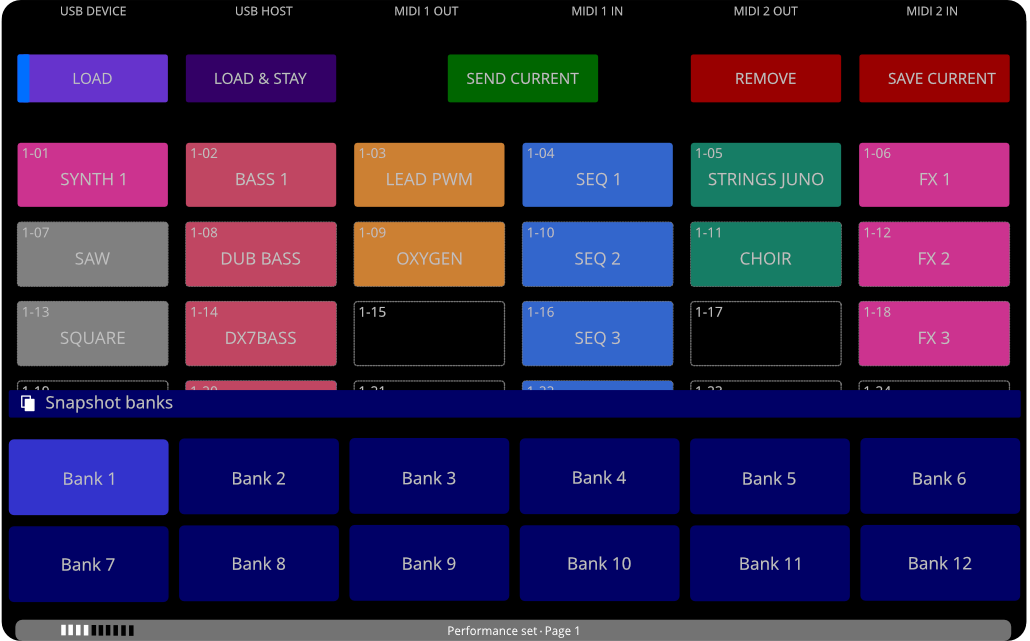

There are 12 banks, each having 36 snapshot slots. Current snapshot bank can be changed by pressing and holding the [MENU]. The knob touch or tapping the Bank button on the screen can be used to switch the snapshot banks. The snapshots bank selection is shown as long as the [MENU] button is held pressed.
There are several buttons at the top of the Snapshots window. These are to manange the snapshots and send them out to the connected MIDI devices.
Load
Swicthes Electra One to the Load mode. Subsequent tap on any of the saved snapshots will will update the preset values, will send the values to connected devices, and eventually the Snapshots window will be closed.
Load & Stay
Swicthes Electra One to the Load & Stay mode. Subsequent taps on any of the saved snapshots will will update the preset values, will send the values to connected devices. On contrary to the Load, the Load & Stay does not close the Snapshots window. It means you can keep sending the snapshots as long as you keep the Snaphosts window open.
Send current
Sends all current preset values to the connected devices. No data is sent or modified.
Remove
Switches Electra One to the Delete mode. Subsequent taps on any of the saved snapshots will permanently remove them from the controller.
Save current
Switches Electra One to the Save mode. Subsequent taps on any of the saved snapshots will create a new snapshot at given location. When a used slot is chosen, the original saved snapshot will be overwriten.

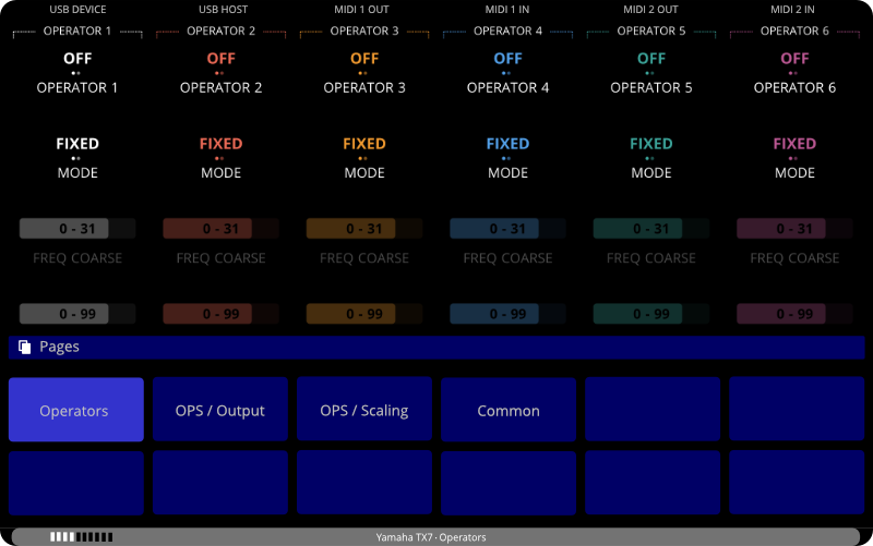

Page selection
Each Electra preset may have up to 12 pages of Controls. When [MENU] button is pressed and held pressed a list of all pages will appear at the bottom of the screen.
Page hint
The currently selected page is highlighted. The page names are displayed so that their position corresponds to the knobs. The knob touch or tapping the Page button on the screen can be used to switch the pages. Empty page buttons represent unused pages, these cannot be accessed.

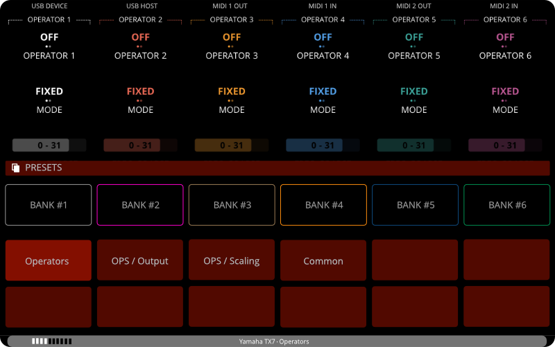

Changing the current preset bank
The banks can be switched by tapping the on-screen bank buttons
Preset banks
Each bank may have up to 12 presets. Once the preset bank is changed, you can choose the preset as described above.
The active bank is highlighted with a colour background:

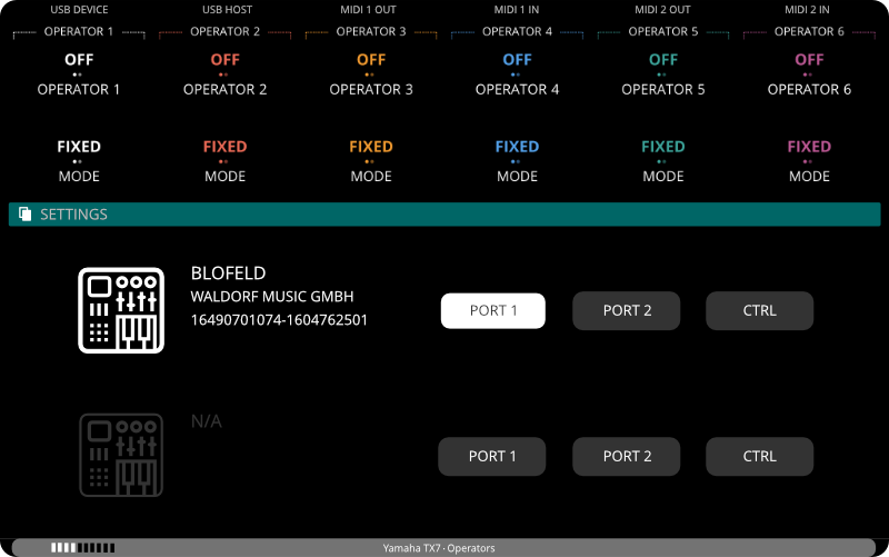

Electra features a <USB HOST> port to connect USB MIDI devices and Electra accessories. Although there is only one USB port, it is possible to connect a standard USB Hub to increase the number of USB ports.
Any USB MIDI device connected to Electra’s <USB HOST> port can be assigned to PORT 1, PORT 2, or CTRL.
To open the USB Host configuration window, press and hold the [MENU] and then press the right-top [PATCH REQUEST] button.
USB Host selection
If the USB device, for example, a master keyboard, is connected to PORT 1, the messages it sends will be forwarded to <USB DEVICE> port Electra Port 1 and <MIDI 1 OUT> port. Any MIDI message sent to either <USB DEVICE> port Electra Port 1 or <MIDI 1 IN> port will be automatically forwarded to the USB device connected to the <USB HOST> port 1. PORT 2 uses the same principle.
The CTRL port is used for Electra's external MIDI control. External control allows you to switch pages and presets by sending MIDI messages to Electra's <USB HOST> port.

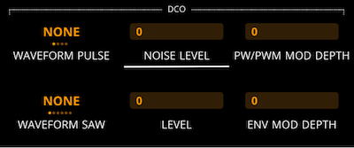

To make orientation even easier, the touch on knobs marks corresponding controls underlined. It means you can see what Control is active even if you do not turn the knob.

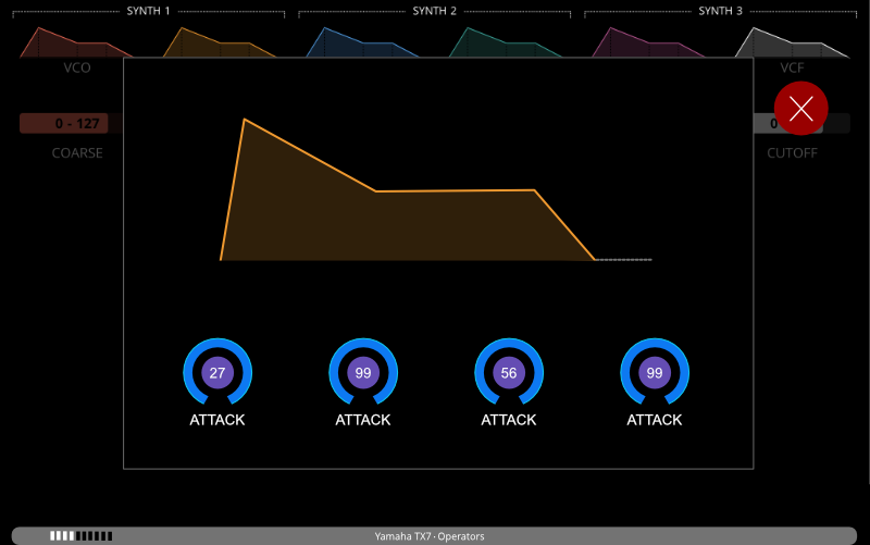

Envelope detail
The envelope detail is meant to allow users to change all envelope values from one place. When the detail window is shown, Electra re-assigns knobs to individual envelope values. This temporary knob assignment is available only as long as the detail window is shown.

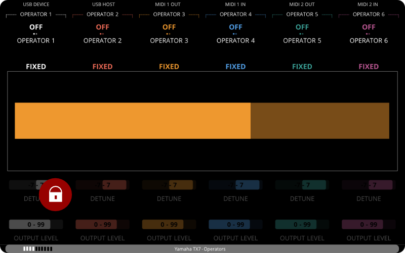

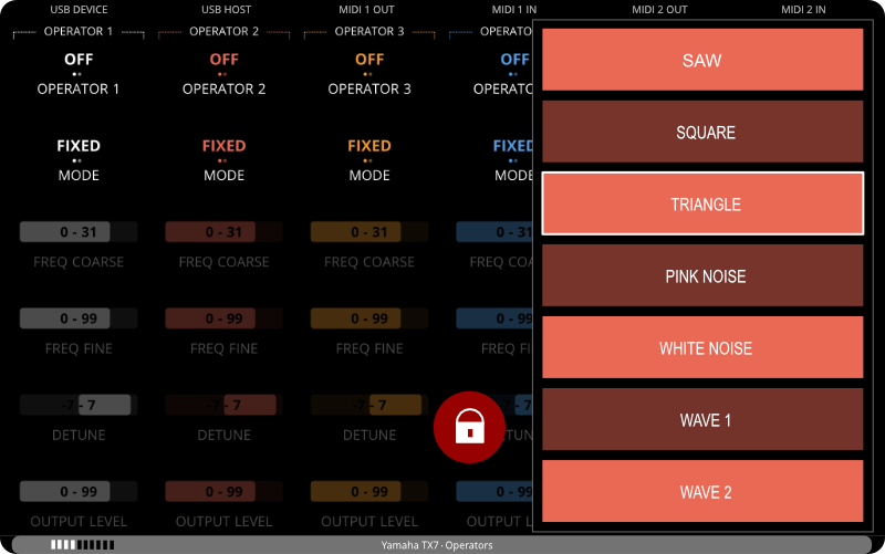

Locking the detail window
Normally, the detail window is closed immediately after changing the value or making a selection. This could be inappropriate in some situations. To prevent this the window can be locked by tapping the lock symbol:
Lock disabled
When the lock is tapped, the symbol gets highlighted and the detail window can be used to change the value many times.
Lock enabled
The locked detail window can be closed by tapping the lock symbol again or tapping the display elsewhere outside the detail window.
