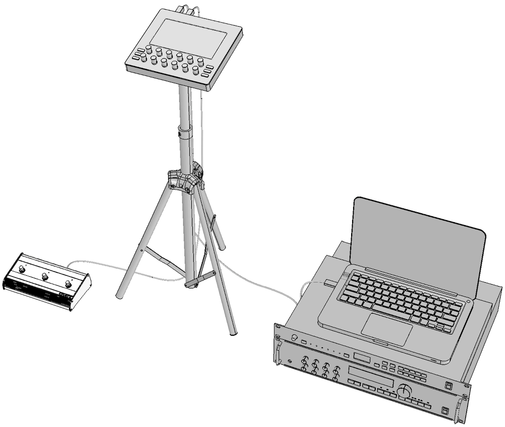

There are often situations during your gig when you need both hands to perform and switching presets of pages could be cumbersome. The external MIDI control provides a neat solution.
Electra with footswitch
The external MIDI control allows you to map a number of Electra actions to MIDI messages sent over to Electra's <USB HOST> port. The currently supported actions are:

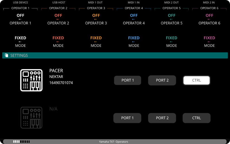

Configuring a USB Host device
In order to use a MIDI Controller to send commands to Electra, it must be connected to Electra's <USB HOST> and assigned to CTRL port. This assignment can be done manually at the USB Host configuration on the controller. Pre-defined mappings of USB devices to USB Host ports can be added on the Controller configuration page of the Electra One Account application, for more details visit Electra One configuration.
